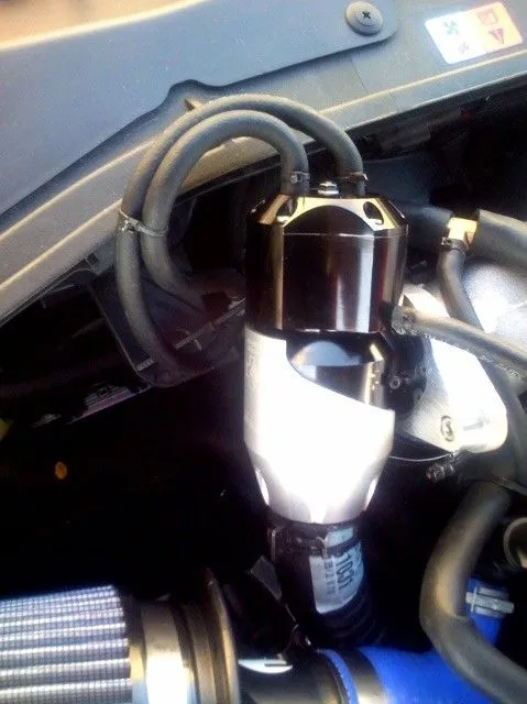

Synapse Hybrid Bov Review

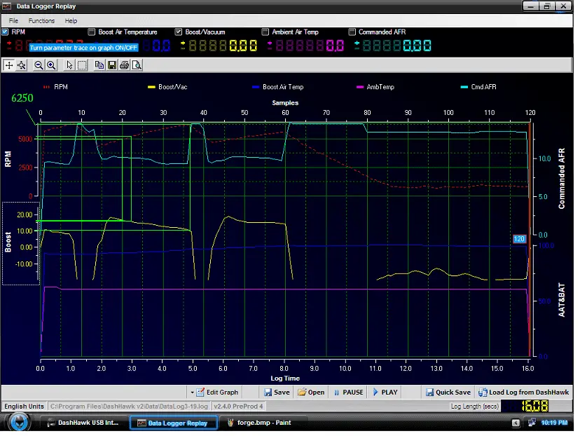

Looked at the 2 charts. how is the new valve holding any more boost? Unless I'm reading it wrong...it looks like both are holding 16ish psi @ 5k rpms and the forge drops off to about 10psi by 6200 or redline. The other log you only go up to about 5200 rpm so you can't even see what happens and of course it's not going to start dropping off by 5200

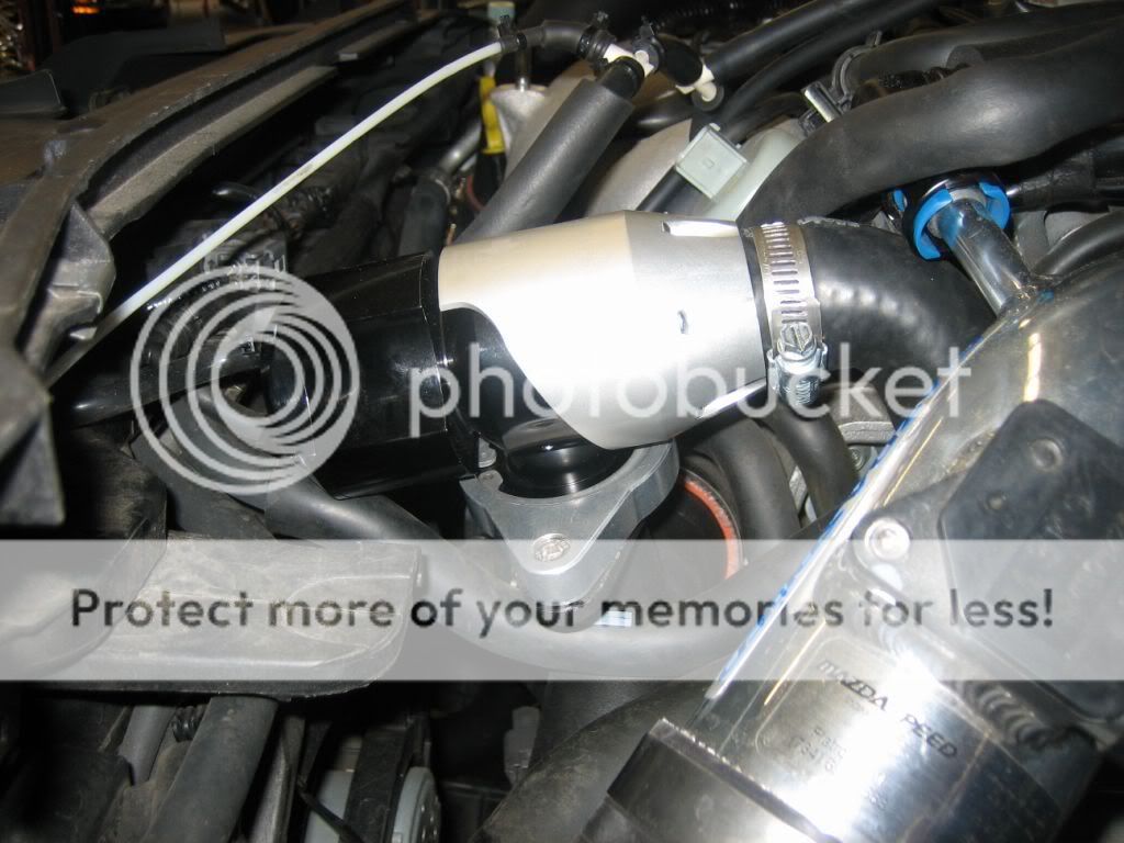

better orientation pic with the Cobb SRI
Its hard to wind out 3rd and 4th in traffic so yes the Rpm is a little off but if you look at the trend of the forge log you see the slant twards taper off... Again im not saying anyone should sell there Forge and buy a synapse at all I liked my forge alot.. Is the Boost drasticaly different ? NO Does the Synapse hold boost better in the upper RPM? YES

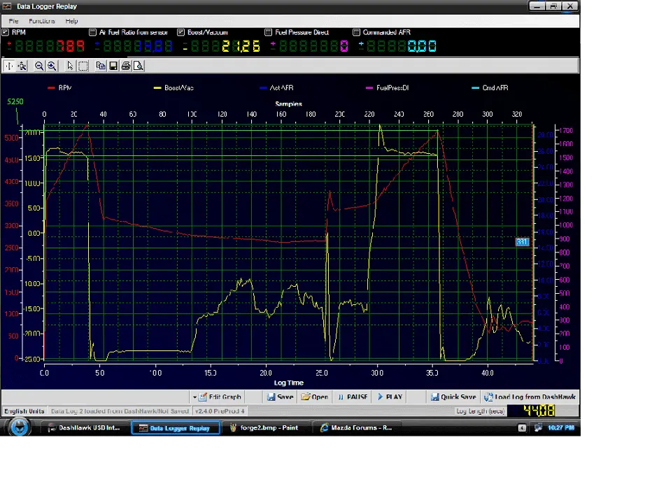

Can we a get a datalog of the new valve all the way to redline so we can compare it to the forge? I am curious as well. I have a forge on the way but I might not like it lol.

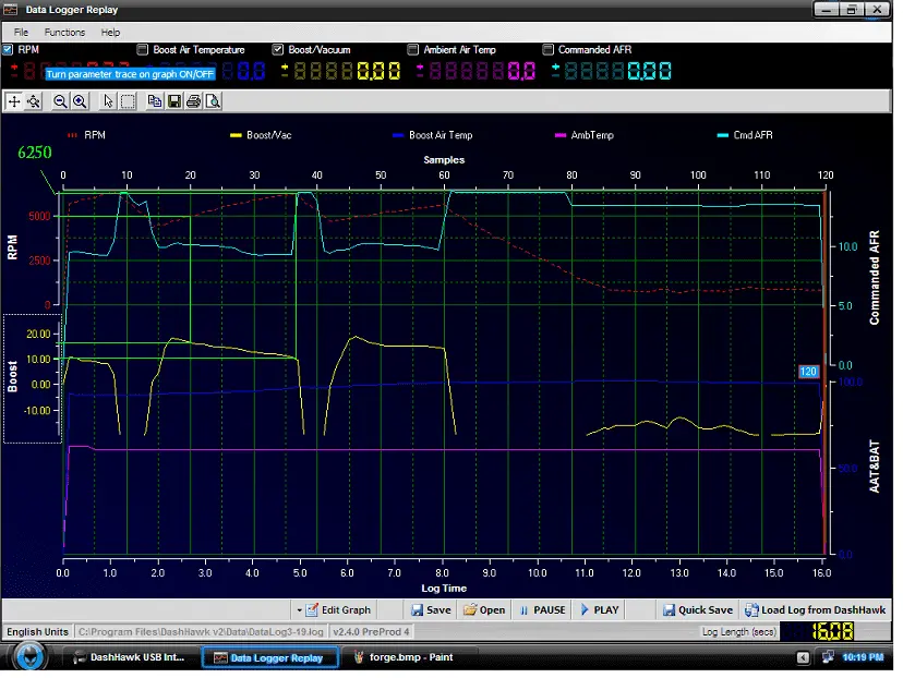

This is what im talking about just fyi...
Randy has a log of the synapse all the way to redline .....
WITH STOCK TURBO?!?!?! lol
if you could get us a datalog with you going to redline that would be awesome
Edit yeah i need to get the synapse log with the same values ...ill se what i can do
Hate to disagree again but that is not correct, lol. Keep in mind the rpm range on the left...theres 1250 rpms between each tick
Look, I'm not trying to say it doesn't hold boost as well or anything like that. There's not enough data. You just said it did and would post datalogs showing it...you haven't. You need to have both valves, same gear all the way to redline to compare really.
I guess I'm just tired of people claiming 'amazing gains' with nothing really backing it up. I'm not saying you are, just based on the data you provided nothing can really be concluded (mainly that the new valve holds boost better).
Do a datalog of the new valve all the way to redline in the same gear as the forge and there will be no more discussion needed! lol
edit: OK cool thanks, look forward to seeing the results
