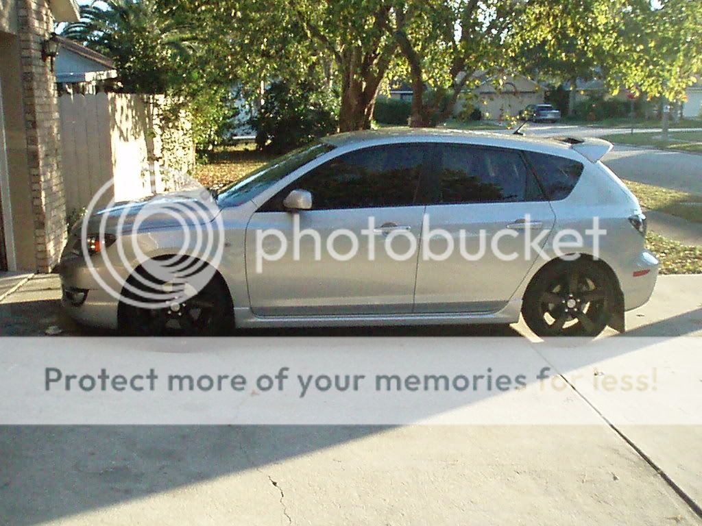

Big thanks to Eric for letting us use his car for the prototyping. He will be well rewarded once we decide what goes into production.
At this point, we're mainly doing the R&D to see what works, works well and is it going to be feasible to go into production. So, give us feedback on what you think.
Here is our development on the Mazdaspeed 3
