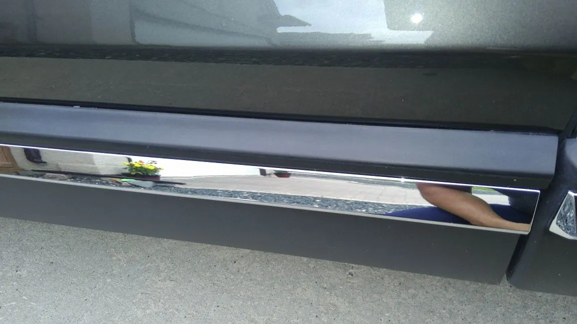

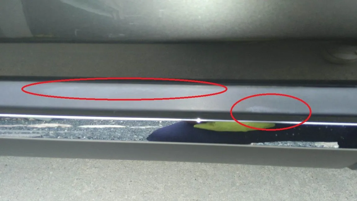

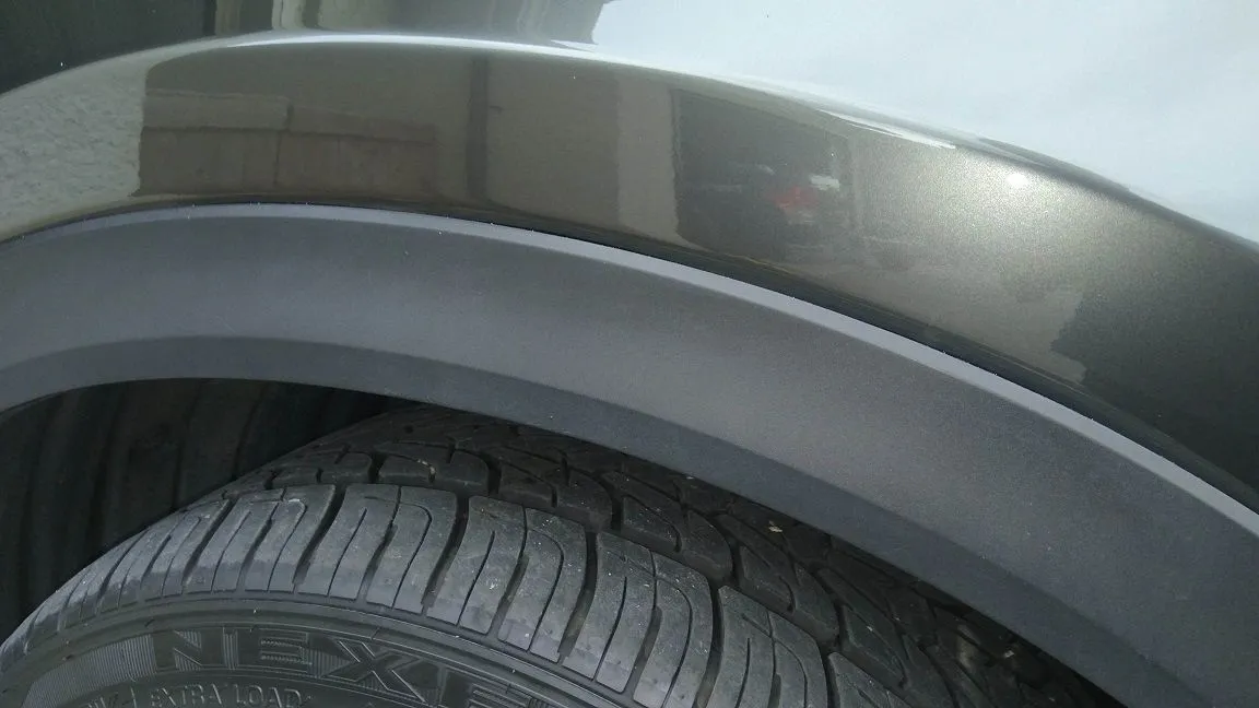

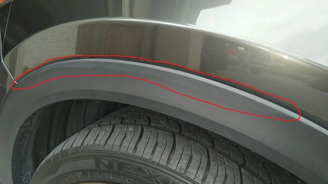

So I reapplied wax to the car last month. This time, I was lazy and didn't bother masking off the black plastic trim, and as a result, there's a bunch of white hazy marks on the trim where I accidentally touched it with the polisher. In keeping with my laziness, I didn't clean the haze off right away and just started trying to remove it yesterday. I used WD-40 and a microfiber, and I thought it would be enough to remove the haze, but I must have left it for too long because the WD-40 didn't do anything. Today I used one of those white pencil erasers (vinyl?), and they pulled the haze right off.
TL;DR: If you have wax build up on your black plastic trim, you can use a white pencil eraser to rub it off. :)
  • Like
Reactions: 323
sm1ke
Work In Progress..
Moderator
Contributor
Canada
'18 CX-9 Signature
Some before and after pics that I forgot to post.
Before:
After:
During:
I'm going to follow up with some Mother's Back to Black for good measure, just need to get to the store to buy it.

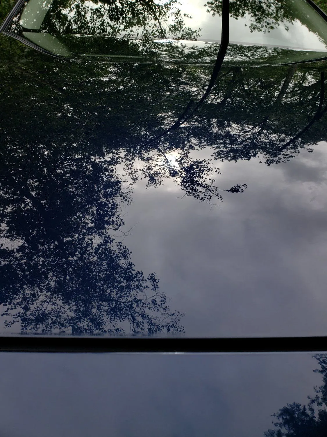

Here's a hack I discovered myself that I've not seen on youtube. I was prepping my car for trade and wanted to clean the stubborn swirls off the inside of the windows--interior plastic off-gassing, cigarette smoke, yada, yada. No glass cleaner works on that, even expensive auto glass cleaners. You think you've got it down pat then the light hits a window in the right way and the swirls are still there. I tried the common youtube hack of clean, clean again with alcohol, then scrub with a Mr. Clean Magic Eraser which does have ultrafine abrasives. Maybe with enough rubbing and scrubbing, scrubbing and rubbing, like Louis Black's personal ball washer (if you get that reference), it might work but it wasn't working for me.
After the alcohol and Magic Eraser, with the sun coming in the garage at just the angle lighting up the swirls, I figured I'd try the Nu Finish on the interior of the windows. Quick, easy, got just about all the swirls. I figured I'd finish it up with some glass cleaner and the swirls came back. Nu Finsh again and the swirls were gone. It's probably not worth bothering with on tinted windows.

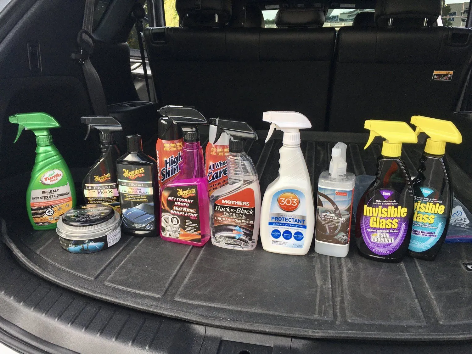

Inspired by a few members on this forum, some of my current vehicle care items. Still working on finding a better soap (currently Meguiar's Deep Crystal Car Wash) but will jump to "Gold Class" once this bottle is finished.
Went on a Meguiar's Amazon.ca and Canadian Tire buying binge this spring during COVID lockdown, and am quite impressed with it, minus the Deep Crystal Car Wash.

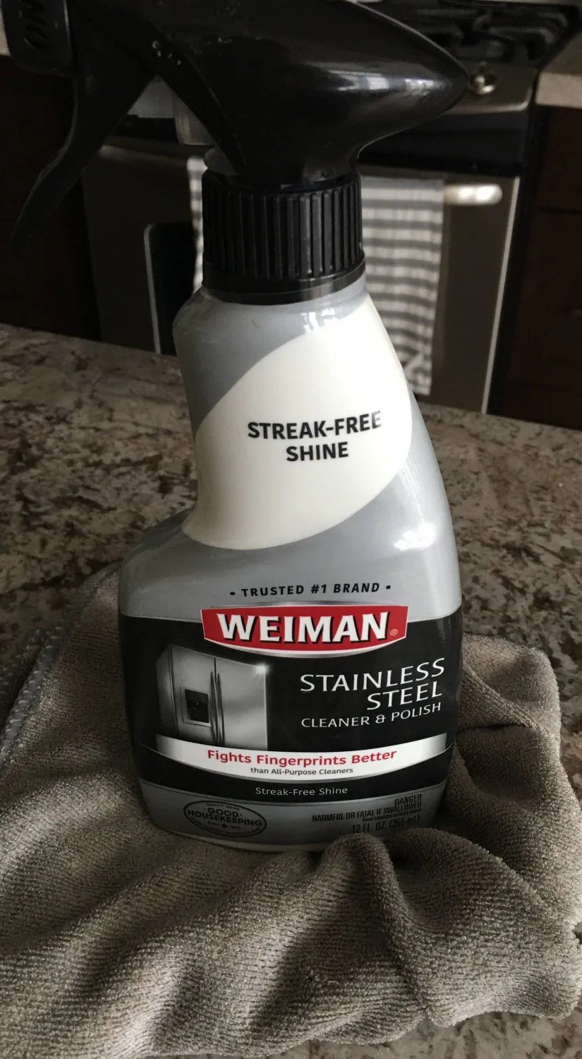

The Weiman Stainless Steel Cleaner & Polish is fantastic for the stainless steel exhaust tips on my 2010 3 Sport and our 2019 CX-9 GT.

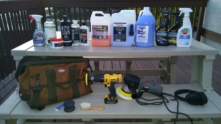

Here's my current line-up of products and tools.
Probably a little hard to read, so here's a list from left to right, top to bottom.
Sonax Wheel Cleaner Plus - Great at cleaning up brake dust deposits. Worked really well on the wheels of my friend's GLK 250.
CarPro Reset - Car wash soap, great to use before detailing.
Griot's Garage Paint Cleaning Clay - Clay bar product.
Blackfire One Step - All-in-one polish/wax product that cleans up micromarring/swirls and leaves a nice gloss finish.
Britemax Max Shine - High gloss polymer wax. Got it for free, will be trying it out over the winter. Hopes aren't high for this one.
Meguiar's PlastX - Plastic polish. I use this to mask the scratches on the piano black trim on the exterior. I've also used it for polishing acrylic aquariums.
P&S Beadmaker - Polymer sealant. This stuff is pretty nice. Goes on really easily and leaves the paint feeling super slick. Great water-beading properties, and after it has cured, it leaves an impressive looking gloss. Durability isn't great though.
Sonax Brilliant Shine Detailer - Hybrid polymer quick detailer. This actually is closer to a sealant for me because of how durable it is. It's a little harder to apply because it's thick and grabby, but it cleans the surface and leaves a durable layer of protection. Great water-beading properties.
Aero Cosmetics Wash Wax All - Economical waterless wash product.
Meguiar's Ultimate Detailer - I keep a bottle of this in the trunk for quick cleanups. Stuff like bird droppings, tree sap, water spots, and dust.
Meguiar's Ultimate Quik Wax - For quick and easy protection. Usually if I have to go through a touchless wash, I apply this as I dry the car to refresh the protection that the touchless wash might have removed.
303 Aerospace Protectant - UV protectant. I use it for all interior surfaces, minus the windows, windshield, piano black trim pieces and the instrument panel cover. I also use it as a tire dressing from time to time.
Boss Bucket tool bag, Griot's Garage 3" pad handle, baby hairbrush, drill with 3" pad attachment, PC 7424XP DA polisher, Bose QC35 noise-cancelling headphones. Most of this stuff is self-explanatory, but I use the hairbrush with soap and water if I ever need to clean anything off of the napa leather.
I also mix the Beadmaker and the BSD in the same spray bottle. I've found that this gets me the best of both worlds - the mixture is much easier to apply than BSD, and it tends to last longer than Beadmaker.
