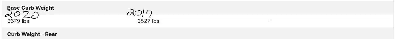

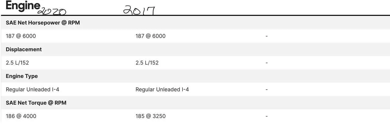

... slightly better acceleration as there is an ever so slight increase in torque and RPM’s...
There is a little difference from FWD to AWD on the final drive ratio that accounts for what you describe ...
4.325 (FWD), 4.624 (AWD)
The various gear ratios 1-6 are the same in each.
That and 150 lbs weight increase and slightly larger capacity fuel tank.
