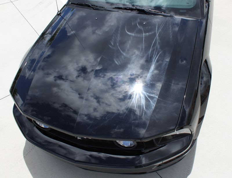

Also in that video the guy is using a Rotary polisher. I would consider that a quite a bit more advanced then a DA since if done wrong you can destroy the paint and it's very easy to induce halograms in the paint. Which look like this:

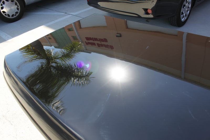

The Idea is to get a panel to look like this:
If used properly a rotary polisher can be much more effective and faster at removing defects then the DA's (standard DA's) There are some very nice DA's that are out now that claim the speed and correction ability of a rotary with the ease of use of a DA. I haven't dropped the $300-$500 on such machines such as the Flex forced drive DA which will always keep the pad spinning, and the Long throw DA's that a 15mm or 21mm orbit compared to the standard 8mm of something like the Porter Cable. I own a rotary but rarely do I bust it out. The time I used it was after respraying a hood panel at my uncles shop for my ford probe, it turned out with some pretty good orange peel, but I knew there was plenty of clear so I wet sanded the panel and buffed with the rotary, but then did a finish polish with the DA. Some pro's are able to get perfect finishing results with the rotary's but I prefer the finishing of a DA.

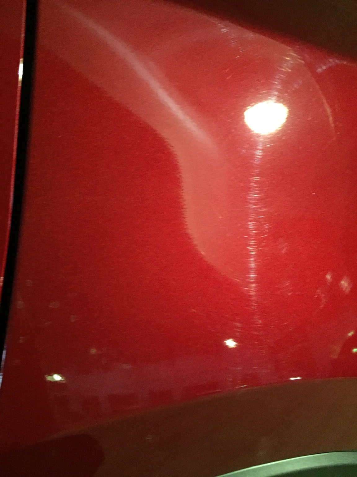

I have them too. Car wash? Either way, it's a fact of life. The sooner you accept that, the less heartburn it will cause; my Bimmer has them as well. [emoji106]
