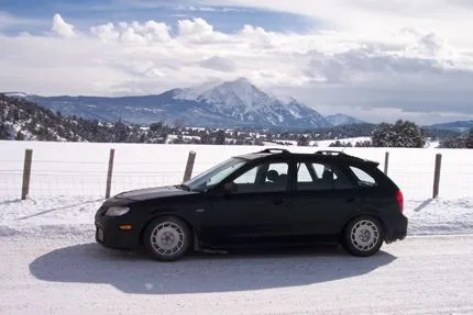

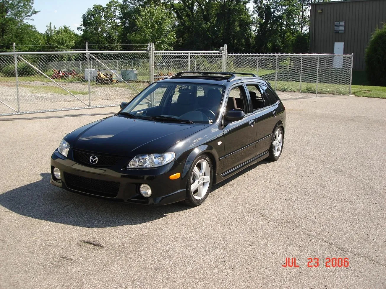

i sold my front MSP bar and only have the AWR 21 rear bar, much better, i was having the same issues as you only i bought skunk2 coilovers and slammed the dam car down, still on stock shocks but this helps ALOT in the sway area, plus i got the car balanced and it corners on rails now..215/45/16 azenis and still no lean... the only braces i have are a cheap ebay MX6 upper rear strut brace, very little cuting to make it fit the P5 and the stock front brace.. the car has no lean, a pic from last week after buffing car...and winter spec with the rear all the way up, still low and still turns!!
