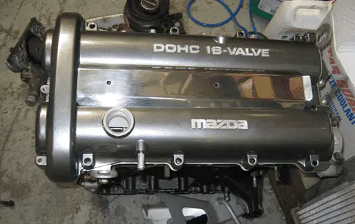

JITB said:
yea but the 1st gens ones look better....lol
i beg to differ!!!
