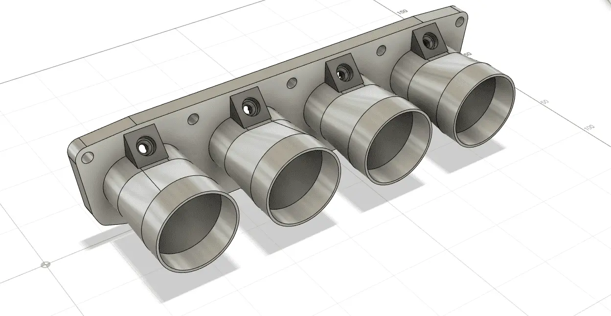

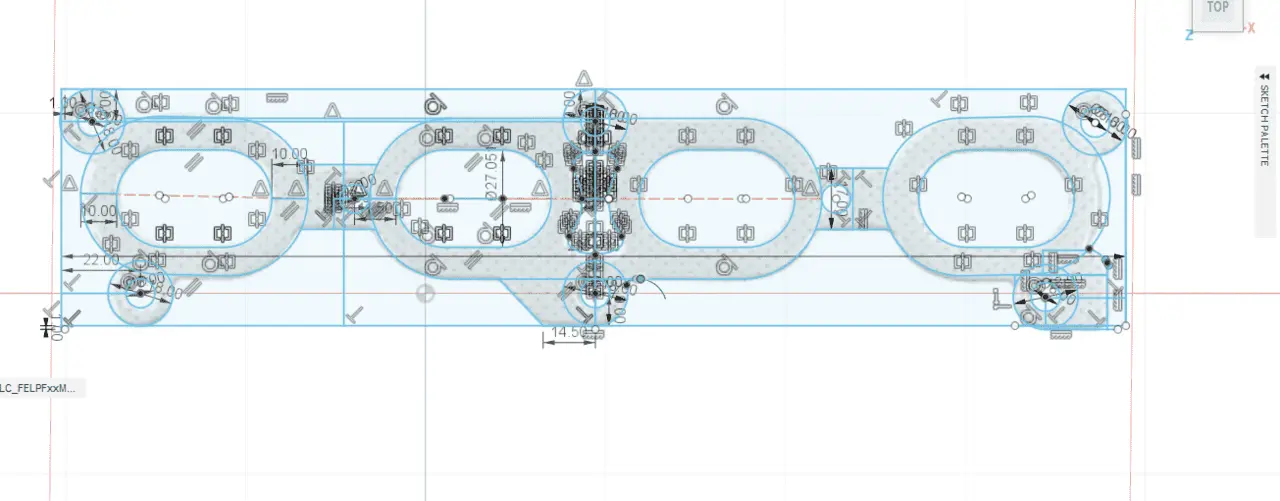

I'm currently in the process of making a ZM/B6 head swap kit and i'm having one hell of a time finding the dimensions of stuff like intake and exhaust mani flanges (port size and spacing etc). Does anyone have models or drawings of these by chance?
