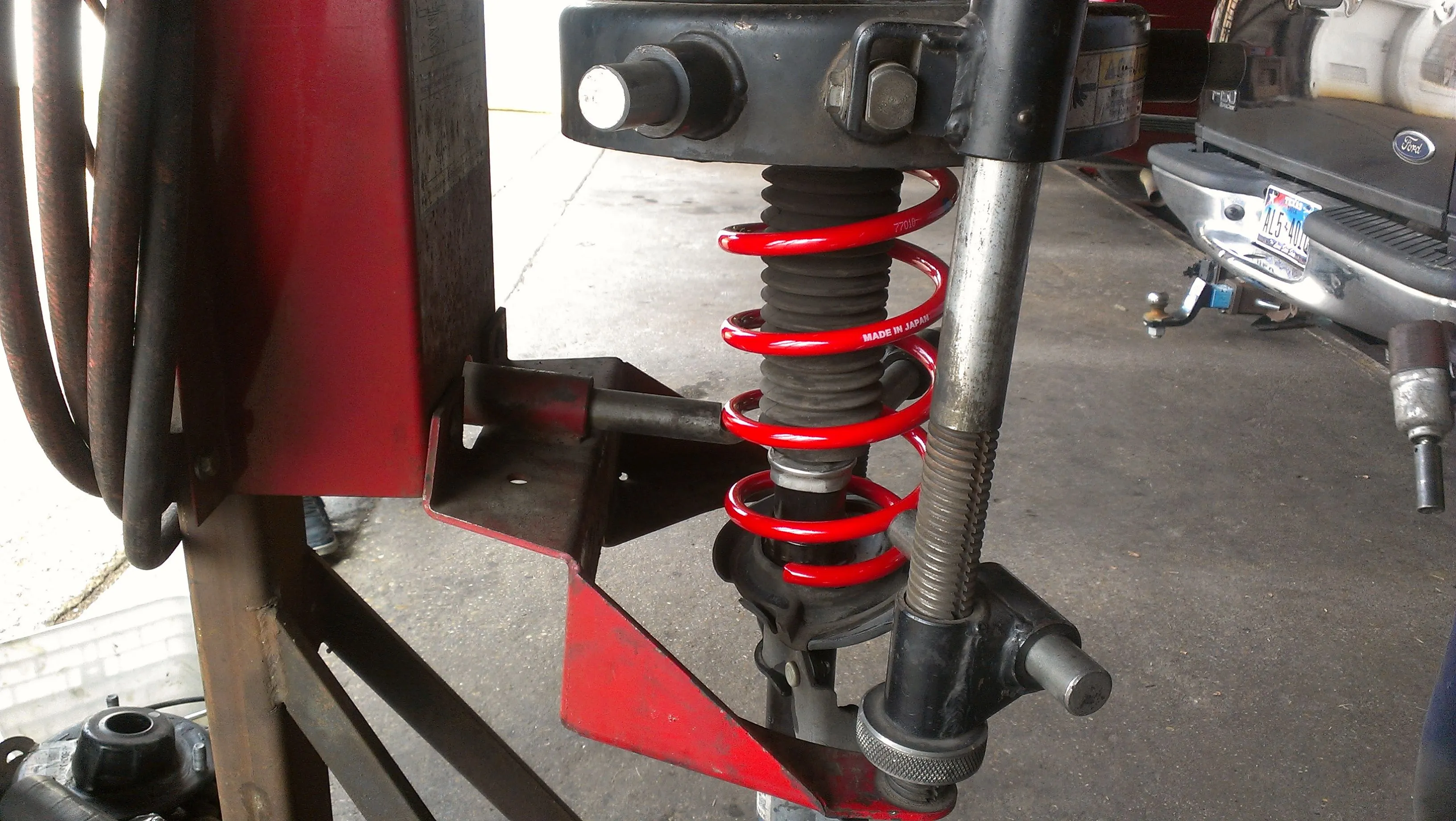

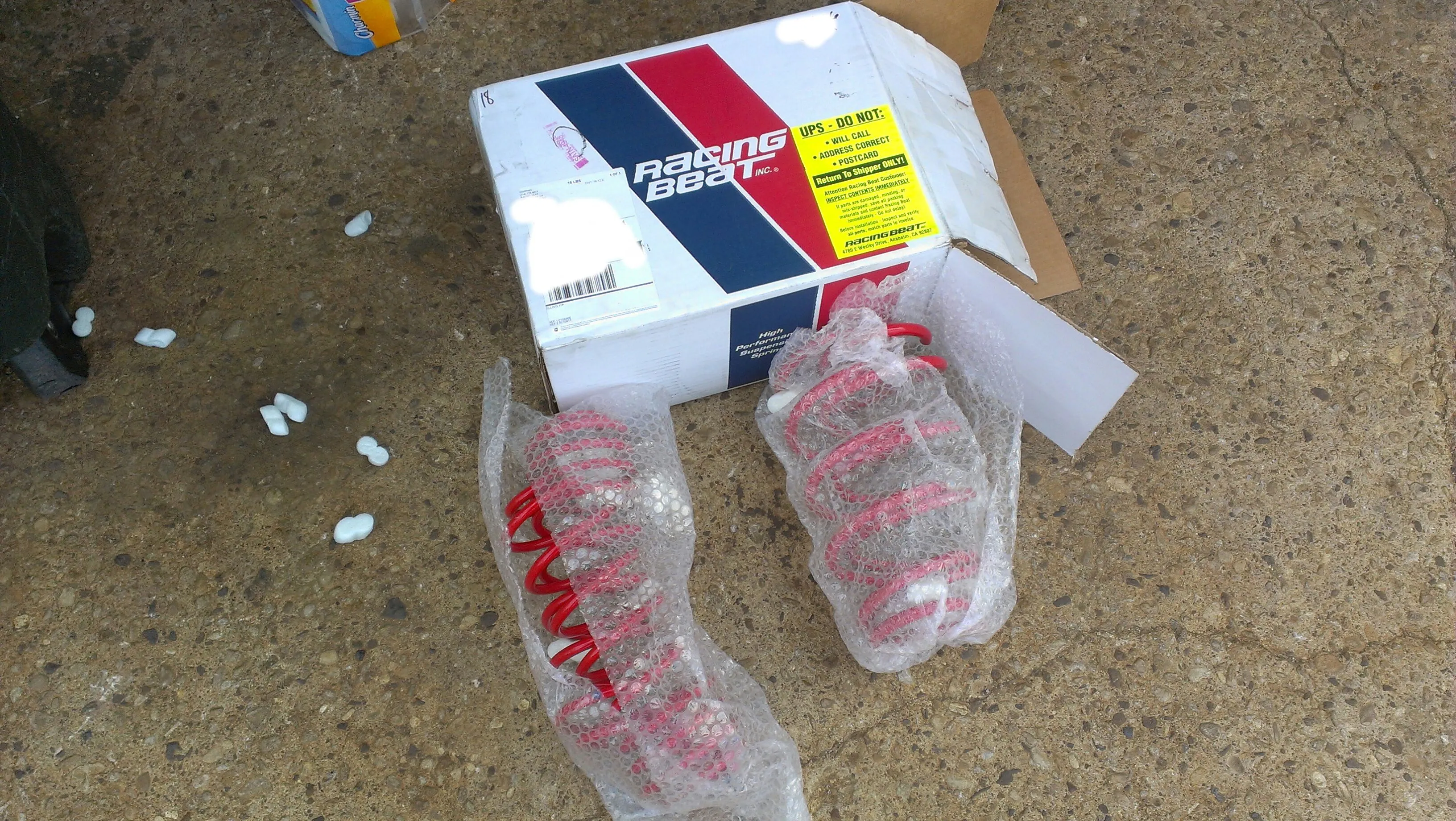

Can anyone with H&R springs or Racing Beat springs please take a picture of their springs with either one of their wheels off? Or even, do you have pictures of the springs out of the box?
I'd really appreciate it.
The only other solution they had was to rotate my top hat which they'll do next weekend if the sound persists.
Pics

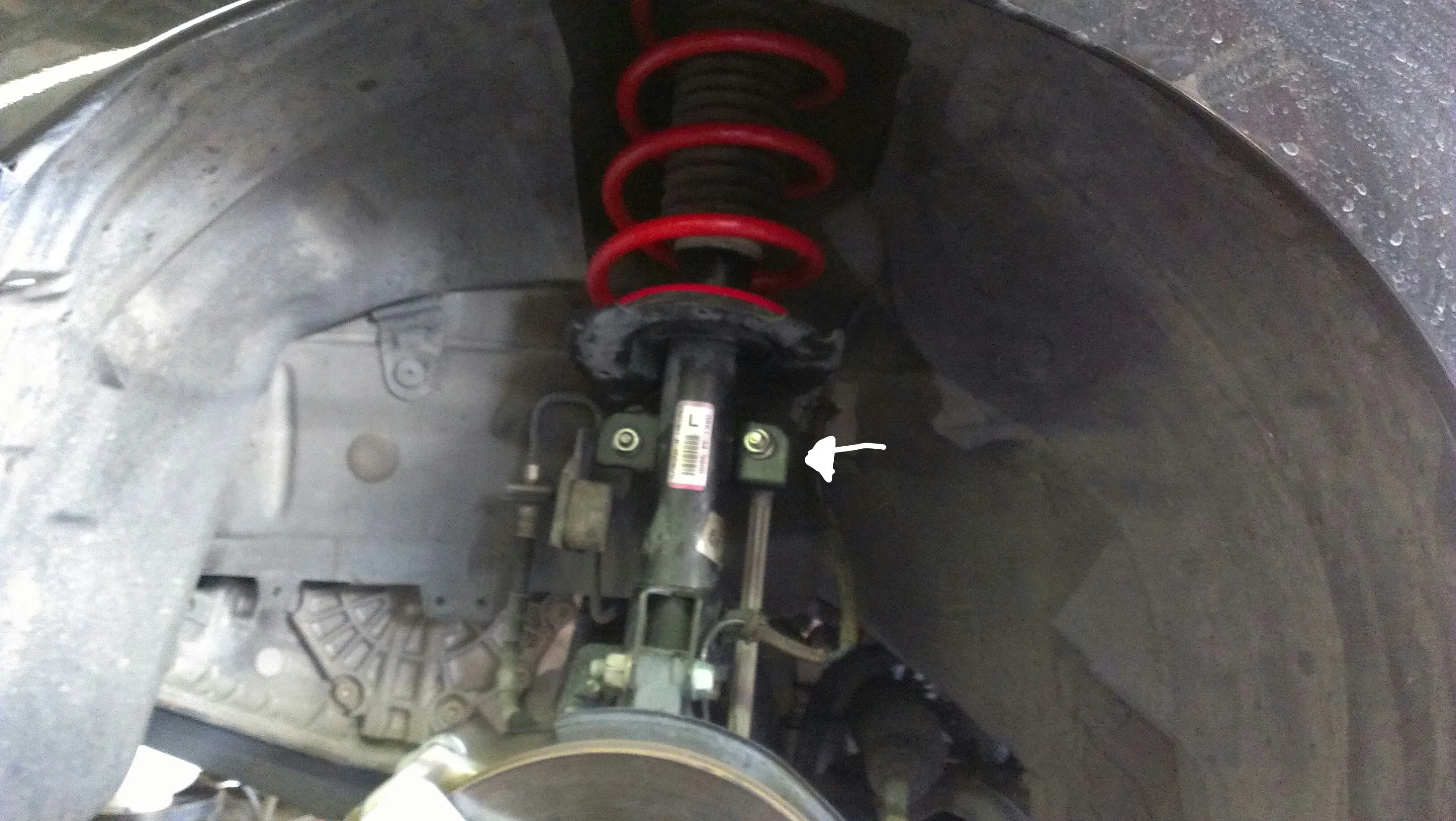

This will make a clunking if not tightened correctly.
thank you ryno. It's really appreciated.
we've already inspected the top nut and all the strut tower bolts for tightness. As well as the sway bar end links. I'll forward the pictures to them. once again i really appreciate it
No problem if that dosen't work it may be they did not index them correctly. There are alighnment holes on top and bottom perches.
