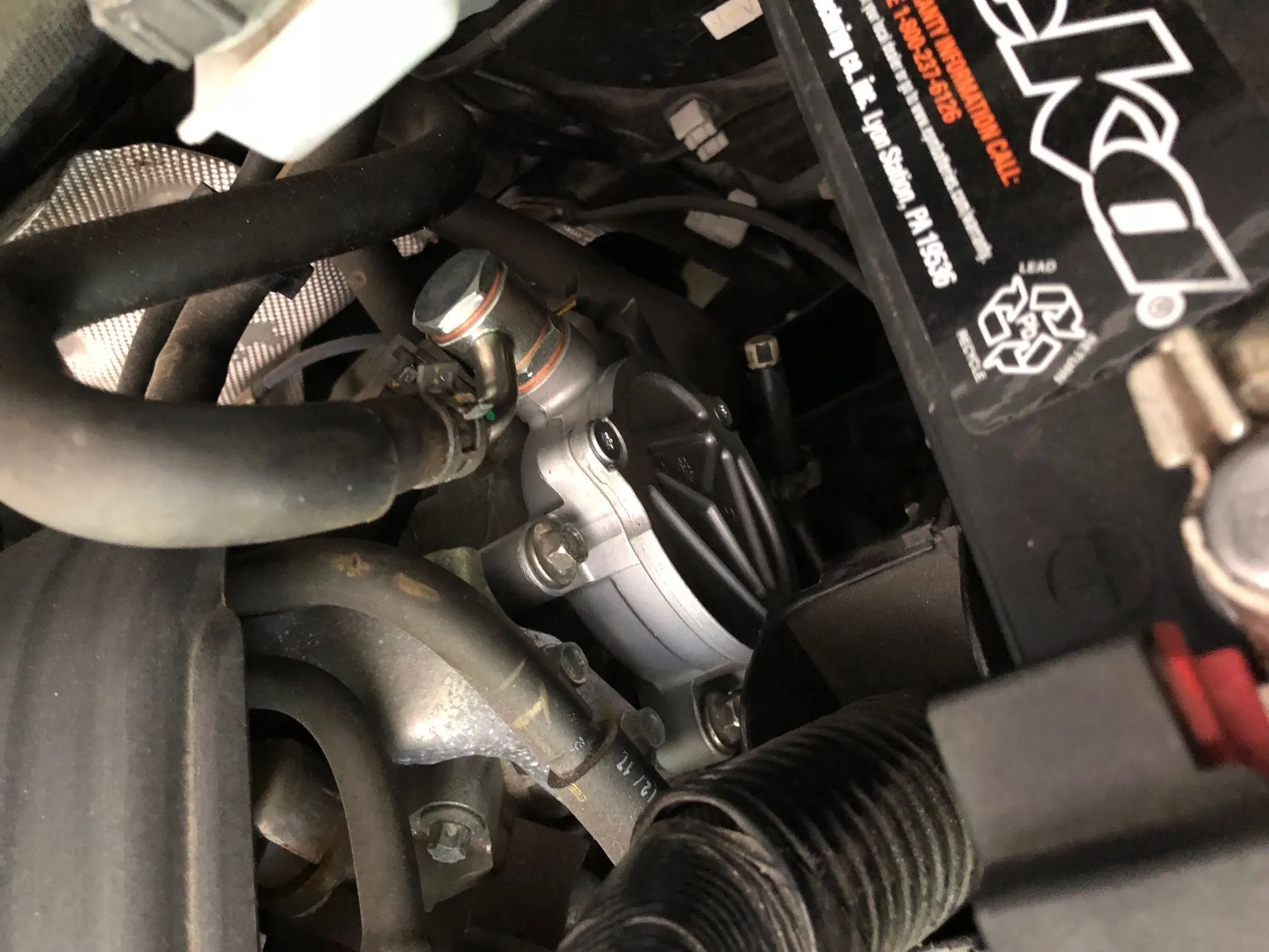

Which vacuum pump? This repair has to be costly ⋯![]()
Still couldn't figure out which vacuum pump you're referring to as it must be located under the engine top cover. If you can tell us the part number that would be great for the person with similar issues.It’s bolts on to the battery side top of the engine. After looking at the new part I probably could have done it myself. It’s used for the brakes and air conditioning as well I think. The engine was making a rattling squeak sound at idle. It is mechanical and after a google search seems this is a common problem. Anyway my Indy had to order the pump from Mazda and it cost me $265.00 for the part and an hour of labor. The left strut was blown leaking oil so I had them replace both. Car feels tight again and at least no rattles or squeaks from the front end.
What is the vacuum pump for? Is it under the engine top cover as I couldn't see any vacuum pump with the cover on around the area.Damn dude, should have said something here. I have one from my old engine sitting in storage unused lol.
Originally I thought it was that big round power brake "booster" which was having problems on early diesel CX-5's. It's the first time I saw people here having this vacuum pump problem and I'd like to know more details. Thanks to both of you for the info.
