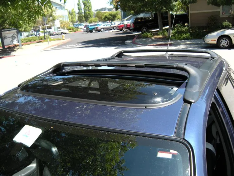

Installed
So I installed the deflector this weekend, and I very happy. It fits with the roof rack on and it was pretty easy to install. Wind noise is cut way down. The place on ebay seems to be legit too. Genuine Mazda part for half the price of an aftermarket. I was all freaked out when it arrived because the box looked like someone sat on it (never mark fragile on a box unless you want FedEx to use it as furniture), but it was protected well in the box so everthying was fine.

Pics
One other thought about install. The instructions said to attach the hook to the deflector (with just enough tightening of the nut to get it on), then to put the deflector in place and mark where the hook will be. This is so you can take it off and place clear protective stickers where the tabs will be. But if you go back to put it in place for good, it is harder to line up (because the metal hooks rotate arround. I found it easier to put a peice of tape over the metal tab not attached to the visor, line up, and attach the nut. But something I didn't concider until after it was already done is why not save all of that hassle, and wrap the protective tap arround the metal tab hooks in the first place (instead of on the car).

Congrats dude - looks good. I know a lot of people on here aren't partial to the sunroof deflectors, but I'm definitely a fan. Sometimes I even forget that I have the sunroof open, it's so quiet :)
