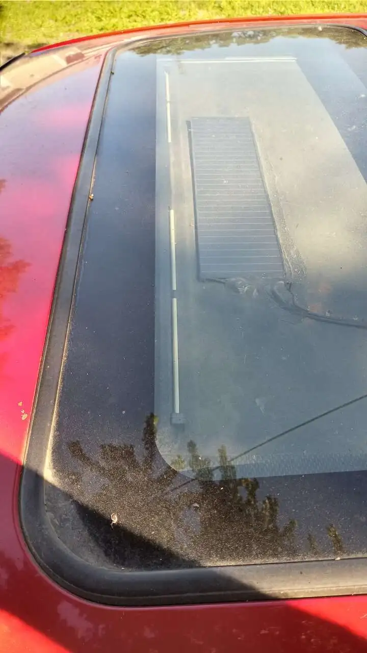

Hey guys, I just purchased my second P5, this time with a sunroof (yay) and I bought it knowing it was leaking. I’m considering deleting the sunroof all together instead of pulling the entire headliner down to fix the tubing, especially considering I won’t really be using it (just added weight to me) I was just wondering if anyone out there has done this yet? Does anyone have any tips or tricks?

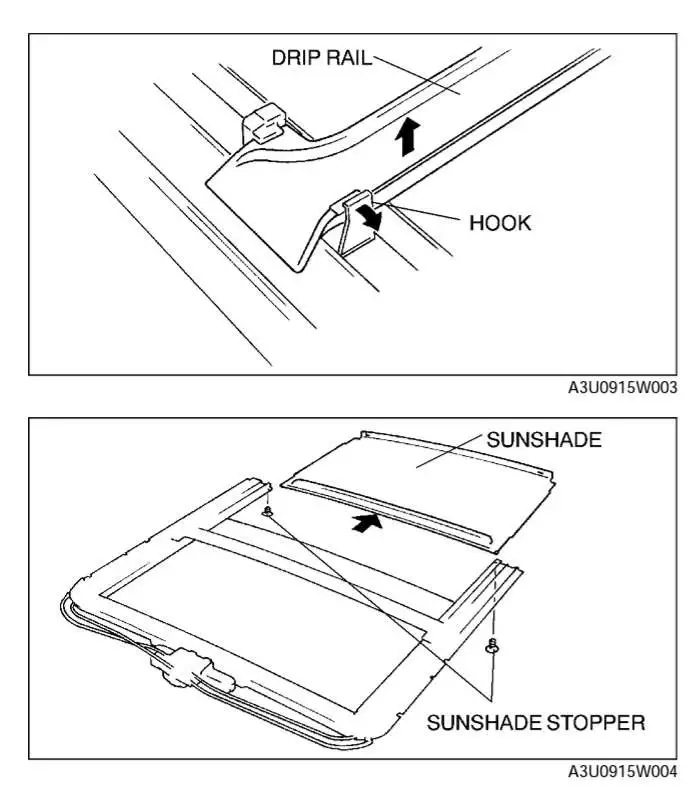

Here is the factory service manual pages for your Protege to remove the sunroof.
One of the steps is to remove the headliner. Here are the pages for that. No need to touch the windshield at all.
The entire FSM for your car can be found here.

Down here we just use silicone to seal them off. I stick to cleaning the seal and using silicone lube to make sure it sits right in the roof. I haven't had one yet that leaked after getting the drain and channel around the glass cleaned.

the vinyl wrap idea seems simplest. being in a bakable area 9 months of the year, glad mine has no skylight. people need to be staring out the windshield anyway, not staring up at the clouds, lol......
OP, good luck with repair and I second the idea of removing the headliner if that's the path you choose. I replaced my rear view mirror with homelink/maplight/compass/temp/auto dimming one and had to run sensor and pwr wires across top inside headliner to get to pillar and the only thing holding up headliner was visor and rr view up by windshield. the seal for windshield was not involved with headliner at all. might be on some cars but isn't on this one. that being said, after removing all you need to free headliner from the ceiling.....there is a big ole hatch opening on the back of the car and seats that lay down that should give you plenty of room to turn at angle enough to get out without damaging it. might take 2 people but still doable easy enough. Just go thru service manual link and follow what it says. it will be tedious but worth it IMO. You can do it....let us know how it turns out.

Lol and how did the vinyl wrap stop leakage?
The sunroof has a weather seal around it, but it isn't 100% waterproof.
There is a drip pan under the glass that catches any drips and feeds it into drains in all four corners of the drip rails.
Those drains can plug up with dirt and crap, then water starts falling on your head.
You can try to clear the drains but it is a lot of work to get to them so instead, you just seal the sunroof shut with silicone, vinyl wrap or duct tape.
