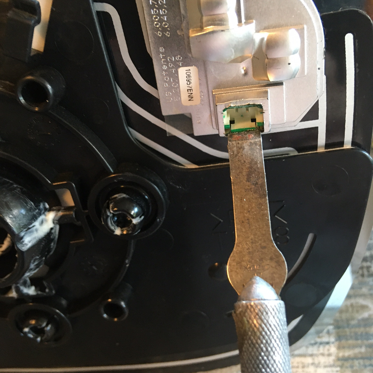

The first pair I was sent didn't fit right, they were too small for the opening. I contacted Eddie and he immediately refunded my money and issued a return label so, absolutely no problem with customer service. The second version became available three weeks ago and I received them a few days later. Perfect fit this time around. I encountered two minor issues with the installation I should mention. The oem connector for the BSM is a pain to get unhooked from the factory glass. Having read the Mazda instructions online, I messed around for a long time with various screwdrivers trying to get the clip unhooked with no success. The instructions are vague at best and the included drawing is worthless. Finally got them unhooked with a blunt-nosed x-acto blade inserted into the low side of the connector.
The second issue was that, after the Suma mirrors were installed, I couldn't rotate the view quite far enough towards the inside with the control. I figured out there was an obstruction caused by the two prongs for the heated mirror. On the oem glass, the connectors are bent down parallel to the glass. The Suma mirrors have connectors that stick straight out, causing an interference with the inside of the mirror housing. Simple fix was to bend the prongs down 90 degrees with needle nose pliers like the factory mirrors. Like I said, just a couple of minor issues.

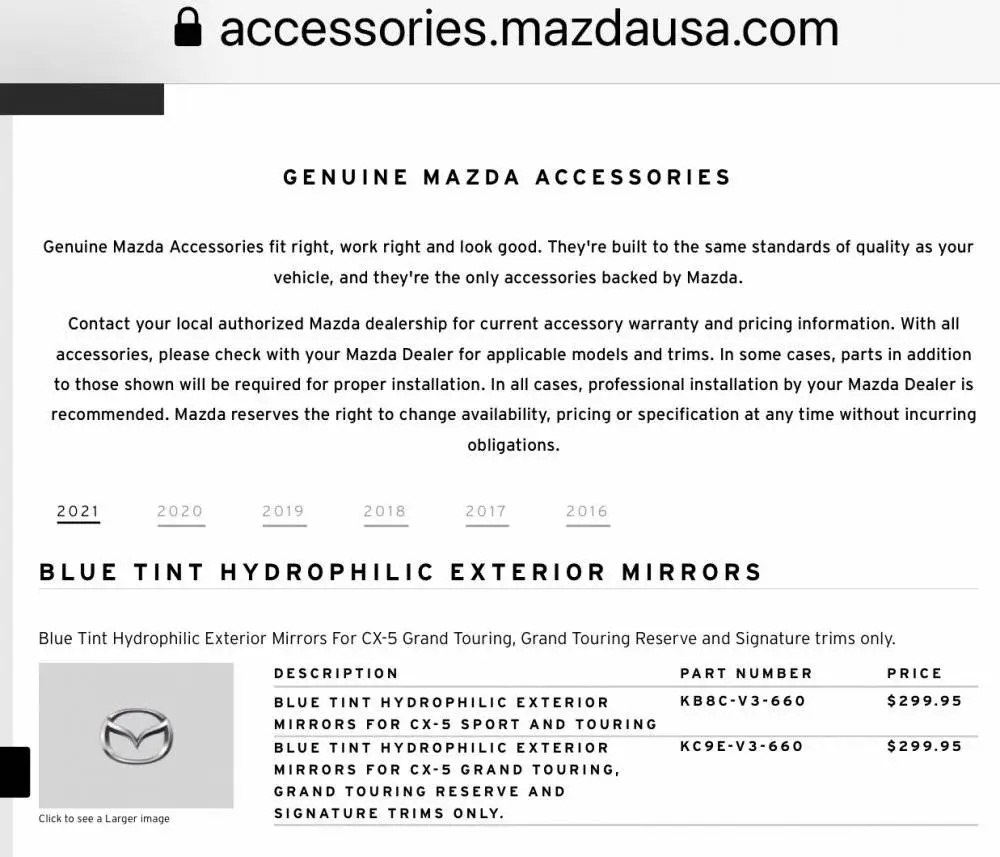

I guess if I really want these blue tint outside mirrors where my 2000 BMW 528i has them from factory, I’d get them through Genuine Mazda Accessories.
Genuine Mazda Accessories fit right, work right and look good. They're built to the same standards of quality as your vehicle, and they're the only accessories backed by Mazda.
I couldn't find a description, but from what I can tell the Mazda mirrors have an anti-glare coating but are flat like the originals and don't increase your field of view, which is the main reason I went with Suma.
According to a long-time member TheMAN who is very familiar with the JDM parts, these genuine Mazda blue tint hydrophilic exterior mirrors are wide angle convex for BOTH sides.
Of course you can always go to a Mazda dealer checking these mirrors out and verify.
they are most certainly for LHD USDM KF CX-5
for the money spent, I would've imported the JDM blue ones instead... they are wide angle convex for BOTH sides, and that means it doesn't matter where the steering wheel is... nearly eliminating blind spots
