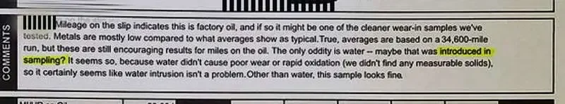

And I just did with my 2019 Nissan Sentra with 50k miles. I bought it used but thought only prudent to change the pan oil and filter. Took about an hour and half . I also did it on my MAZDA that was very easy took an hour. It was well worth it and did show everything I mentioned in the first response. The service was at 15k miles and again at 23k miles in which I had the oil analyzed.
Oil sample | Blackstone Laboratories
My question to you is did you have it done to your personal Mazda and that is why you are saying it was a waste of money? ;)
This is the information conclusion and note again this was a sampling at my second oil pan and filter service.
