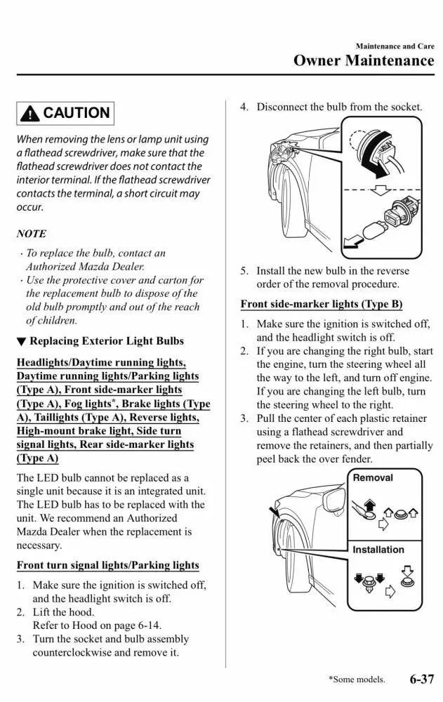

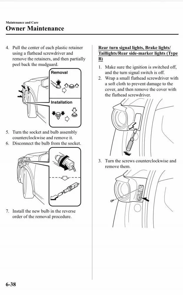

This’s exactly what my 2016 and this 2018 CX-5 owner’s manual says:
