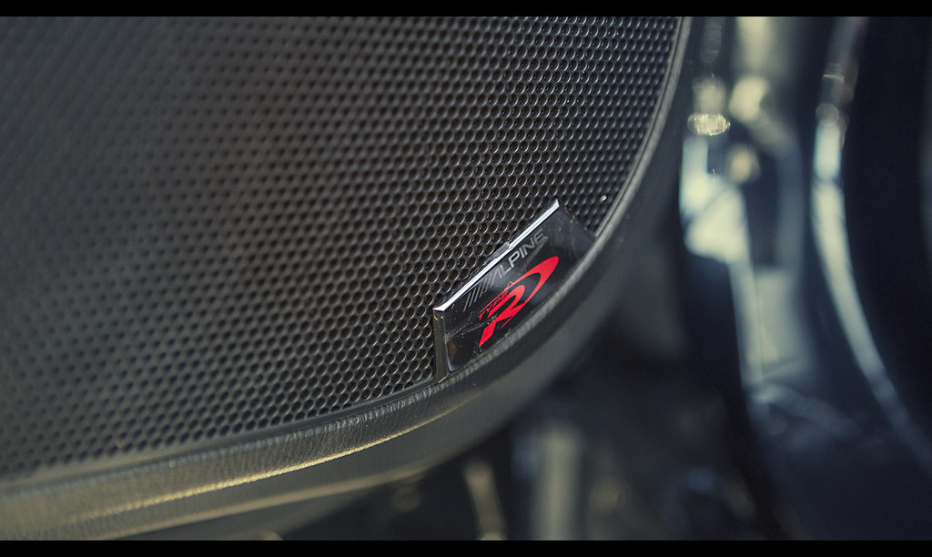

Fronts: Alpine SPR-60c
Rears: Alpine SPR-60

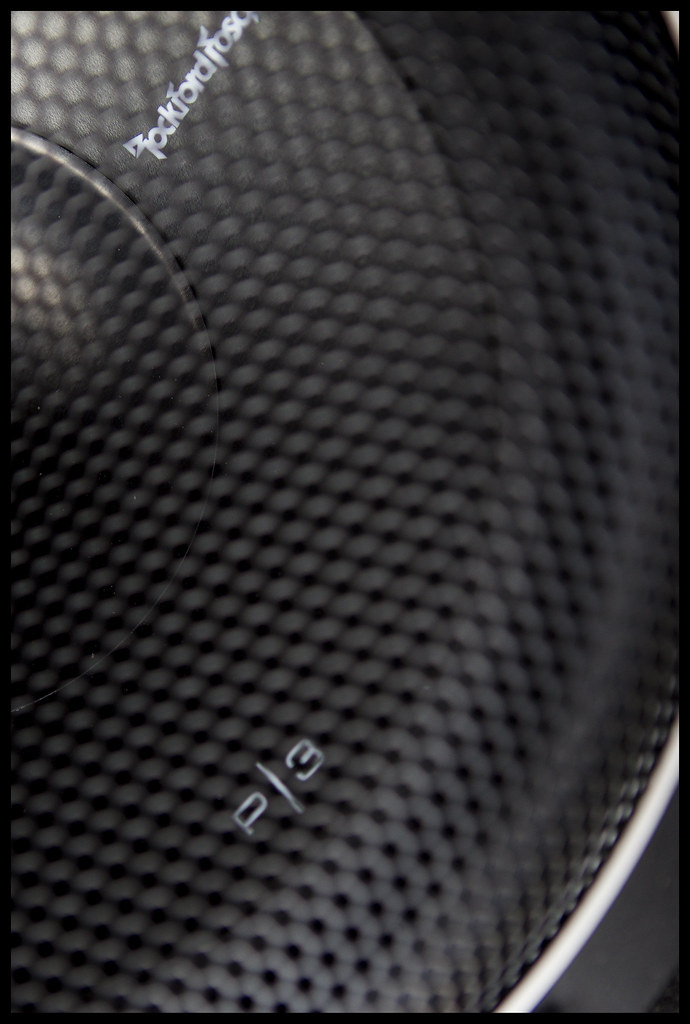

Sub: RF P3-D4-12" - 4ohm

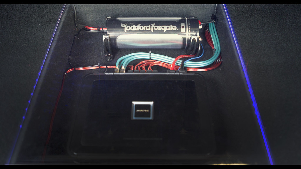

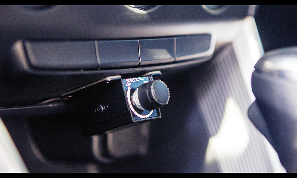

Amp: Alpine PDX-V9 .w Remote Bass level knob (birth sheet 1 x 564WRMS + 4x138WRMS)
Cap: RFC-1 (1 farad)
Tied it into the stock head unit using the regular high-level (speaker) outputs and RF speaker-line to RCA converters.

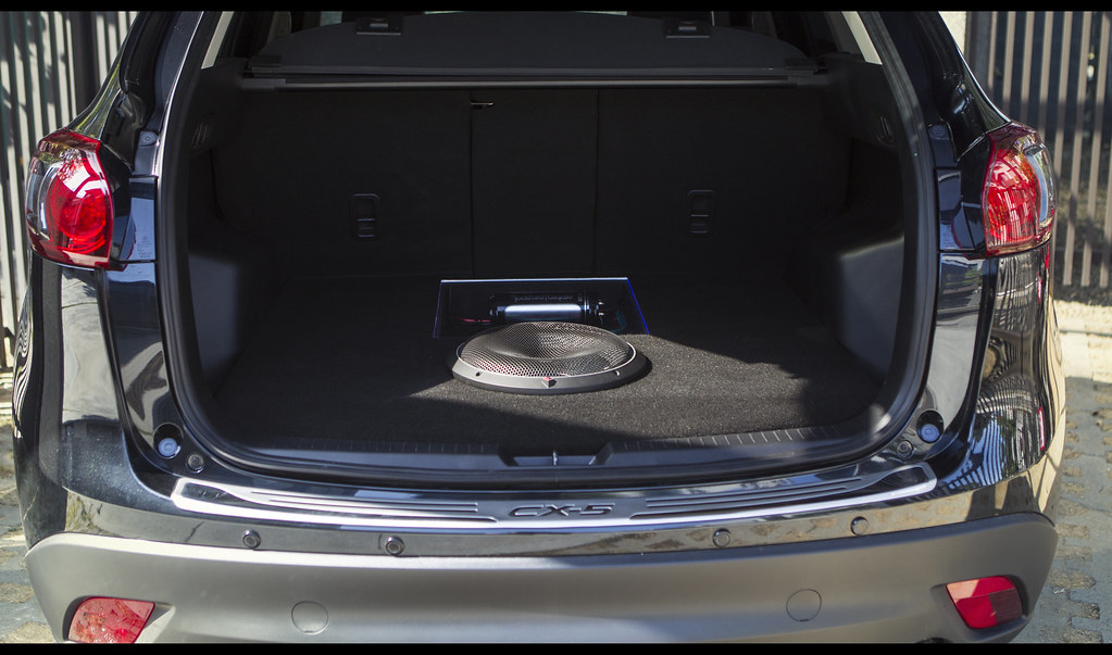

Custom box with the blue LEDs tied into the hatch-open sensor, so they only come on when the hatch is open.
The basic idea was to keep it all usable, so if I need to carry cargo, I slap on one of those rubber-trunk protectors and have no problem carrying any cargo..
