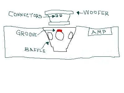

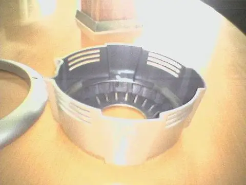

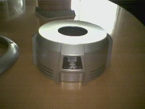

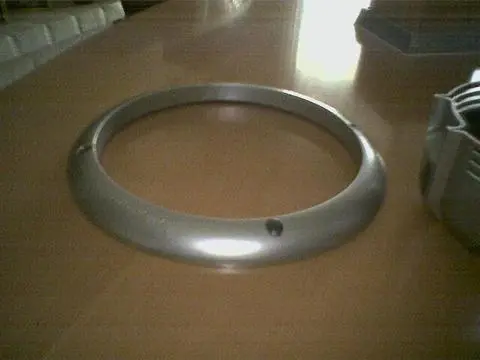

I asked the same questions here a while back about a replacement sub and I was going to get the JL 8w3v2 4 ohm, but I couldn't justify paying $140 for an eight inch sub. So I decided to go check out Trader's Village(a really big flea market here in Houston) just for s**** and giggles and I found a place that would sell me a RF Stage 1 for $45 and a Stage 2 for $65 brand new in the factory sealed box. I pulled out my measuring tape(yes I actually brought a measuring tape to the Flea Market) and a sheet of paper where I had written down all the dimensions for the factory sub and sub box and I started to measure the dimensions of the RF sub. The measurements indicated that it would fit. I've been away from the car audio world for a while now so I wasn't sure just how good Rockford Fosgate subs were these days(they were pretty good in the early 90's), so I decided to play it safe and get the Stage 2 4ohm sub which is supposed to handle 200 watts RMS. Well to fit it in the factory box you need to take off the removable magnet cover(just dresses up the back of the sub) and cut a little groove into the sub box's inner baffle to make room for the rather large, awkwardly placed push style connectors. You can make it fit without cutting the baffle but it will bend the connectors a little(not a good idea). The subwoofer's holes line up perfectly with those of the factor sub box and I was able to reuse the factory screws. After I installed it, I decided to check and see if the factory grill woud fit and to my surprise it fit like a glove. You can't even tell that I've changed out the sub unless you stick your head in the trunk and look up.
Oh yeah I almost forgot the most important thing: This sub kicks ass. Best $65 I've ever spent. It plays clean tight and low. With the rear seat backs folded down I can't see out of the rear view mirror when playing rap or bass heavy music and now I have to hunt down a rattle coming from either the leading edge of the headliner or somewhere under the dash. Not bad for an 8".
oh nice....i know you have it already hooked up, but if you're feeling even more generous can you post some pix of the alterations you made to make it fit (the removable magnet cover you took off and the lil groove you cut in the box's inner baffle to make room for the connectors)? Thanks for the info though either way! I like Rockford's as I dont' know too many ppl who are unhappy w/ them.
As far as a picture of the groove in the baffle, this is the next best thing:
And now the magnet cover and concealing ring(neither will be used):
Sorry about that, here ya go:

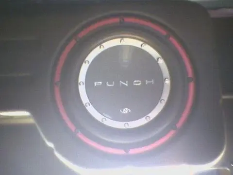

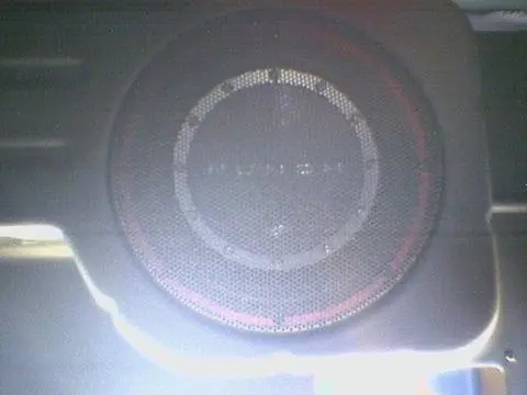

Subwoofer installed with and without factory grill:
