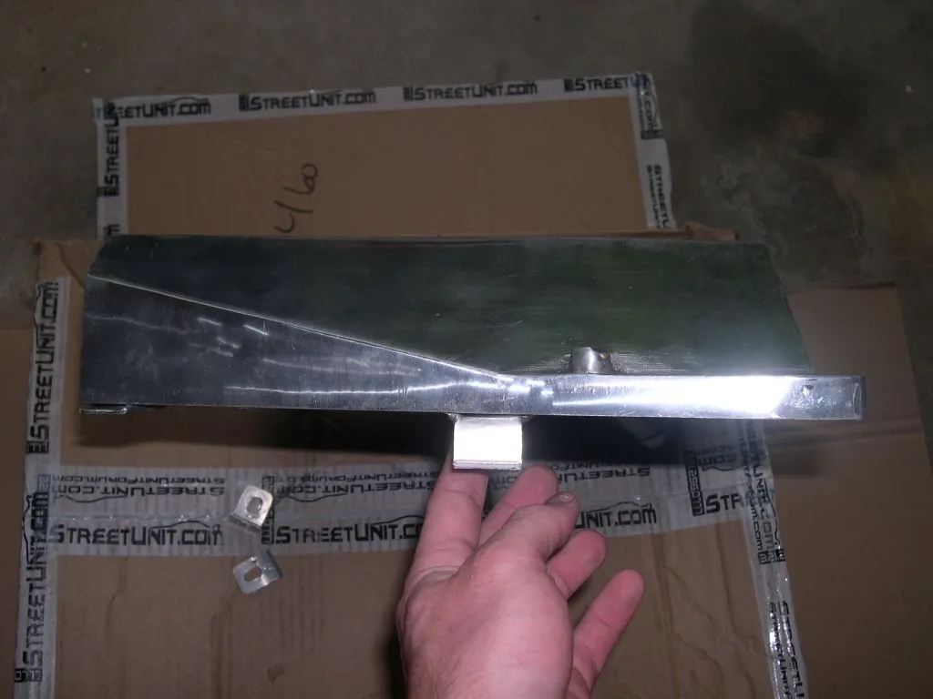

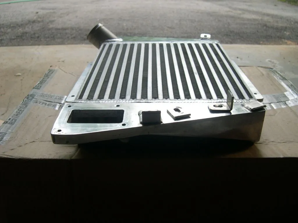

I am reviving this thread after some recent incidents I encountered with the SU TMIC on my car.
First, the SU TMIC is NOT on my car anymore.
Second, the boost tubes I got from SU were sent back because they did not fit.
Third, the shroud made for the IC was not long enough on the front and it caused the two front corners of my air duct seal to be worn down to the metal which then started shaving out notches in the shroud. Mark said he would have a new one made for me.
Fourth, As I merged onto the freeway today, my car started cutting and then died. The two front tabs of the IC broke causing it to fall down on top of the engine. It dislodged the bottom tube in such a way that it blocked most of the opening. I had to wait for several hours for a friend to go to my house and bring me my stock IC so I could get back to my job!
I am so pissed right now, I did spend $600+ for a headache. I told Mark in an e-mail what happened, that I didn't want their IC on my car anymore so they wouldn't have to bother with making me a new shroud. I'm not sure if I want them to give me a ETS in its place, or if I just want my money back.
Sorry, had to rant, made my work day go for an extra 4 hours due to all this.

Were they because of bad welds?
No, the welds did not break, the tabs themselves did. Both of them broke in different places.
