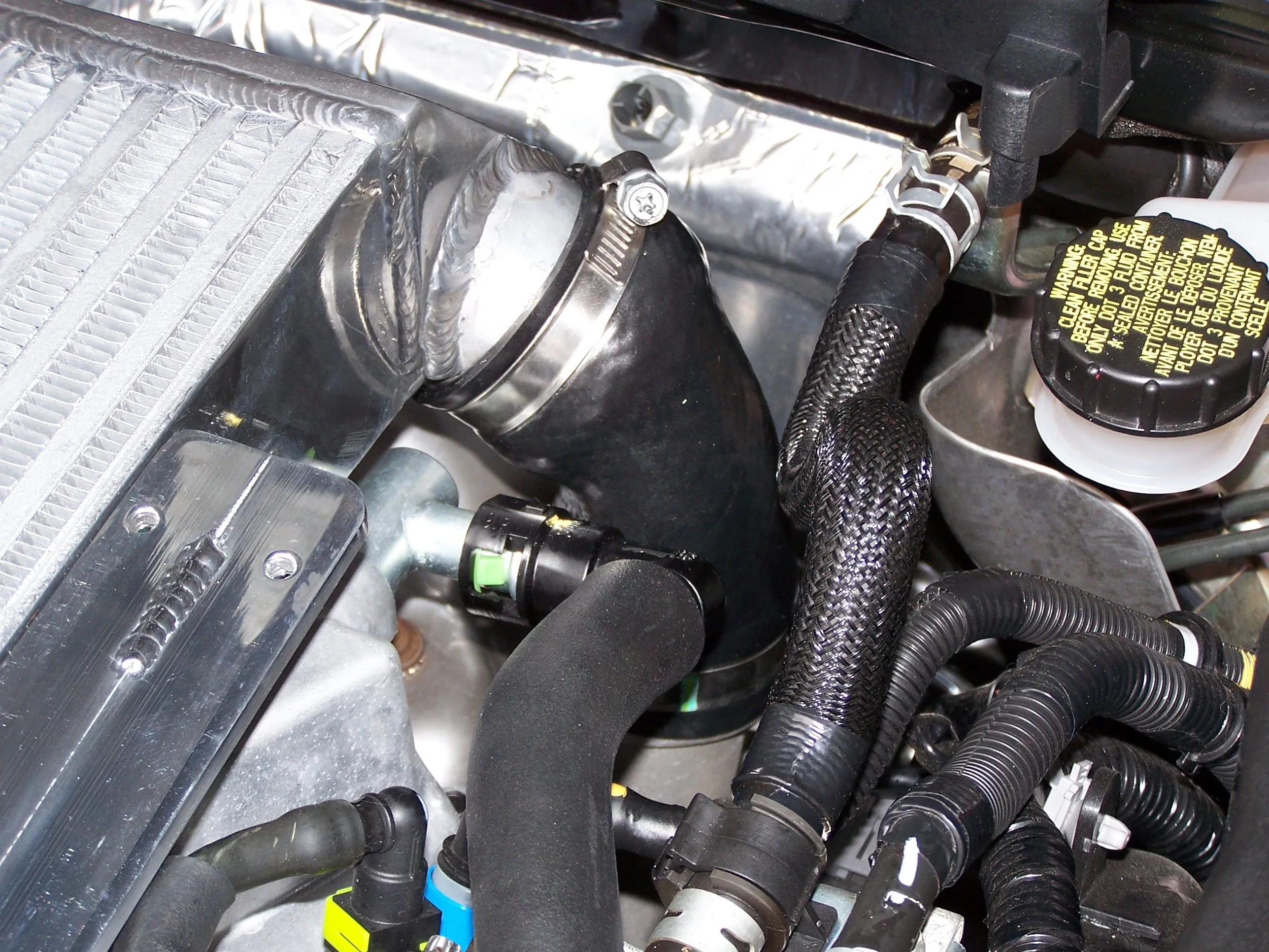

SU TMIC Installed.
i would assume that this "recall" would be for anyone unhappy with there product who is having fitment issues with there rear tubes...
and my stock tube is on there now and its slightly kinked too...so i am definitely going to get a new one when they make it
Are these issues with the boost tubes only issue with the SU TMIC or is it the same with the ETS TMIC???
I also called SU and they told me they were working on the problem. I got the impression that they were going to have a new tube made specifically for the SU TMIC.
I think that would solve the problem. I wouldn't mind trying another manufacturers tube, but I think most of the ones available would be a 45 degree angle tube. I not so sure 45 degrees is correct, so some custom angle would have to be produced.
I think SU will have a custom one made, at least I hope they do.
Until then I'll use the stock tube.

I believe the fix is as simple as a tube with a longer bottom half with a slightly flatter angle going into the TMIC. 45 degrees is angling upward too much, therefore when you bend it down to meet the IC, the top flattens and the inside collapses - it kinks or buckles.
papa yours fits pretty well I think. Mine has a fold in the middle.
Mine does have a small indentation at the 45 bend, but not too bad. However, it did take two of us to put it on. I held the IC off the studs at a 45* angle while my neighbor got the tube on and tightened the clamps, then I set it down on the studs stretching the tube a bit, but its pretty good.
I just need to be able to remove it and get it back on by myself just in case no ones around.
Bottom line is we need a tube that fits. I think SU will get one that works, we'll just have to wait.
