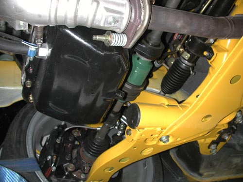

You can also place them on the sub frame, near the yellow cylindrical area in this photo.
Placing them on the pinch weld won't bend them, as long as you let it down slow. Place the stand as close to the wheel as possible.
Off topic, but wow that is clean. I climbed under mine for the first time to change my oil and transmission fluid, and I was happy with mine until this picture.

I'm thinkin that's a fourteen year old picture...
Lol. And damn, I shoulda' got my other first choice color, yellow.
