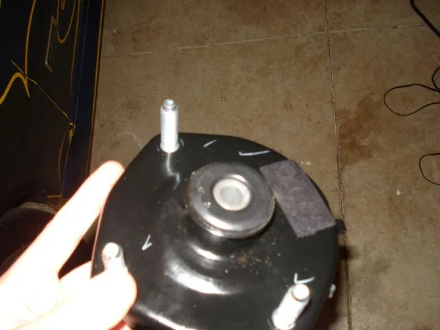

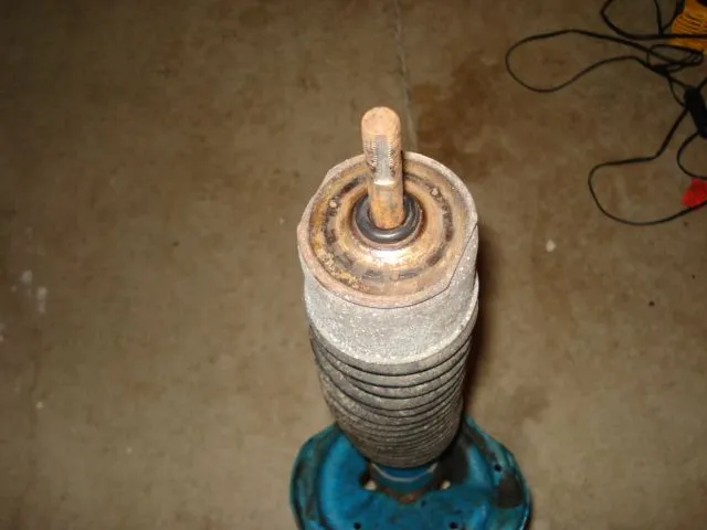

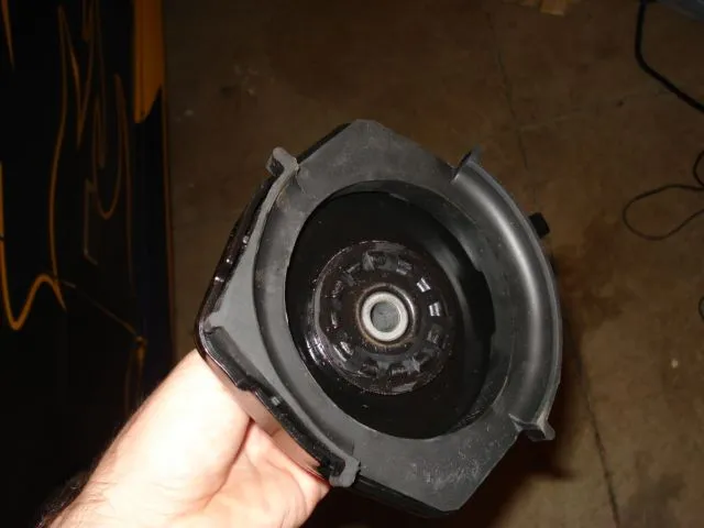

Is this o-ring attached to the strut mount or a separate part/peice? I looked in the manual but didnt see an o-ring. Is it in these pics? Does this o-ring sit between the strut mount and the car frame or between the strut mount and the metal dust boot cover? Also, the manual shows an adjust plate. What is this?

the o'ring is just something like the washer trick
you want that o'ring to sit between the strut mount and the bottom of the threads of the strut piston... you can also find rubber washers you can use to fit between the washers at the top before you put the nut on... hopefully that can cut down the noise
