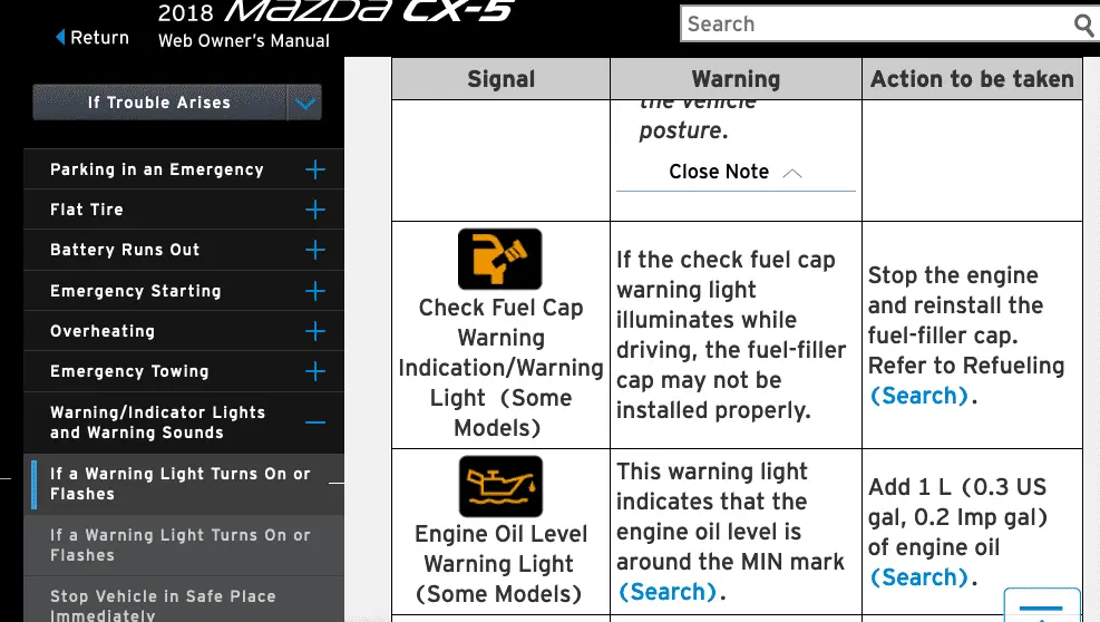

Here's the light that I saw - I was confused since it was not the low oil pressure light which is RED.
2018 CX-5 Low Oil Level warning.webp The Low Oil Level warning light came on only briefly. Now that I added the remaining oil in the 5 Qt jug, the oil reading is fine - a uniform, thick film right between the Full and Add marks.

See my post at 12:30 pm - it has an attached screenshot of the 2018 CX-5 Owners manual. It was not the low oil pressure warning light.
