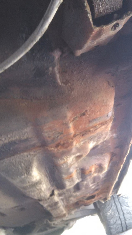

I still can't comprehend this "rust" you're always talking about. I'll try and take a picture underneath my car, but there isn't a speck of rust anywhere on it. Plenty of mud, some dandelions, sticks shoved where they probably shouldn't be lol but none of this "rust".

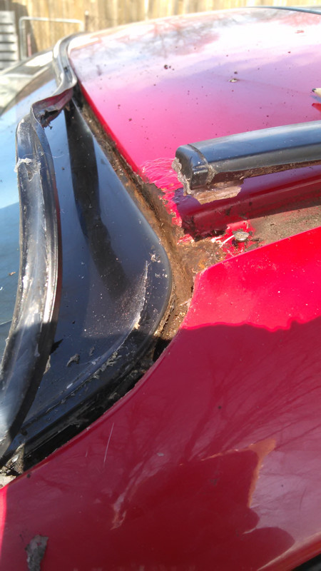

When I got it there was a little surface rust between the roof rack and the door in that little ~2 inch space where the previous owner had a bike rack or something and it rubbed the paint off. I just used some 600 grit by hand, and about 5 minutes to clean the brown stuff off so it was shiny metal. Then a little rattle can love with some white spraypaint to "match". it's not a perfect match, but it's an old car with a ton of miles, and i live on a dirt road so it's never clean anyway so you can't even tell.

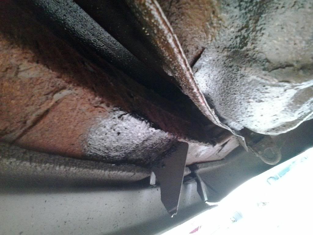

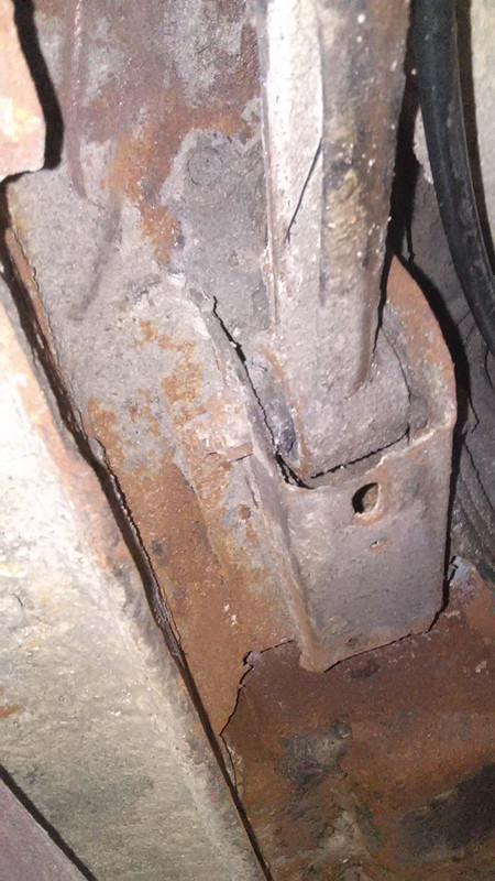

When I went to Krown to get it sprayed he poked his spray wand in the frame rail and said he was hitting the carpet...
I said I don't care... Hose it down...
At least I know my carpet won't rust...

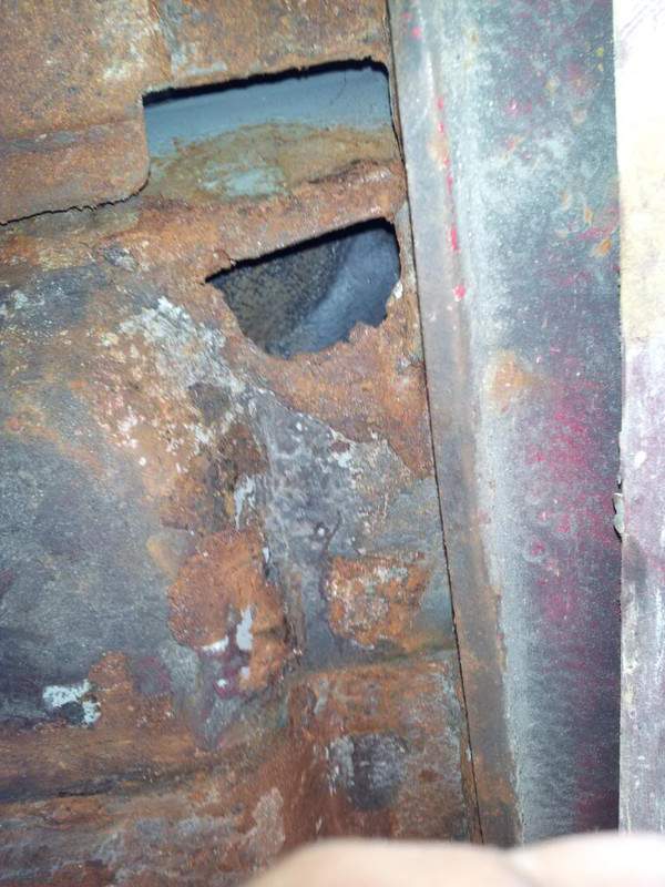

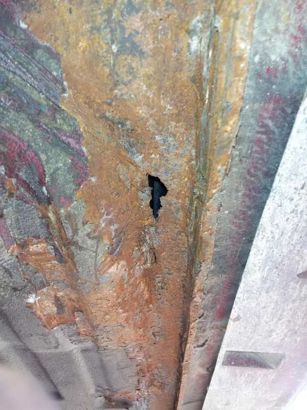

I can't even use my jacking points anymore... They are all crunched in and squashed...
The jack would crunch right through the damn floor.
