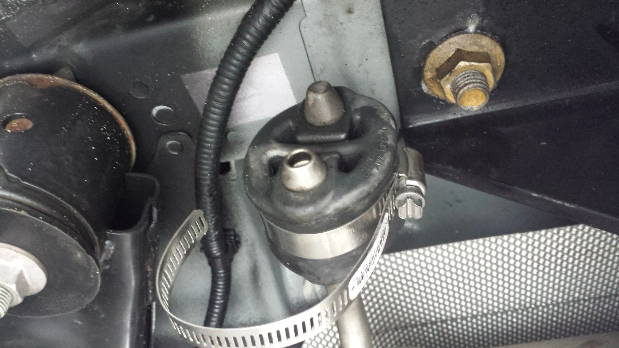

Its the Exhaust! Wired the s*** out of the exhaust at 4 locations to the places that the rubber hangers mount. NO VIBRATION at 2300 any more. So I now know its the exhaust now, "cheese&rice!!! .....

Now I need to find a good fix. Might just make Mazda replace exhaust. But might try new mounts first. either way, happy to have narrowed it down to the exhaust.

brought my cx5 to the dealer, told them what I had found out by trouble shooting with the wire and hose clamps, 4 days later they called me back and said they acknowledge the problem, they said they "took a video" of the problem and talked to "Chicago engineering" Said they are working on a fix but recommend leaving on the hose clamps because it helps the problem.
Thoughts?
