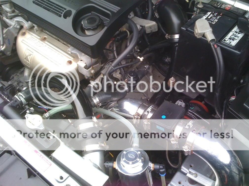

pictures would be nice
update: NVM i found one.
the car is still how it is in this pic... thnx for posting that pic... and wow im dumb MBC is a manual boost controller... but ya no i dont let the car boost that high... in fact since the first time it did that i havent even gone into boost again... no BOV just how it looks in that pic... and what do you mean "connect it the right way"?... thanks to all who are helping... and also the wastegate was set to 11psi no MBC
u dont need to post a pic! that is the injen cai! it hase a aluminum tube that runs down below the intake! dont talk trash about poeples cars unless u know the parts that are in them!
