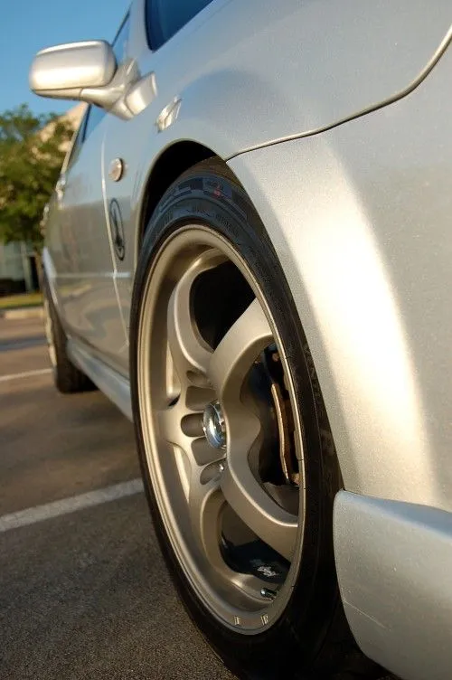

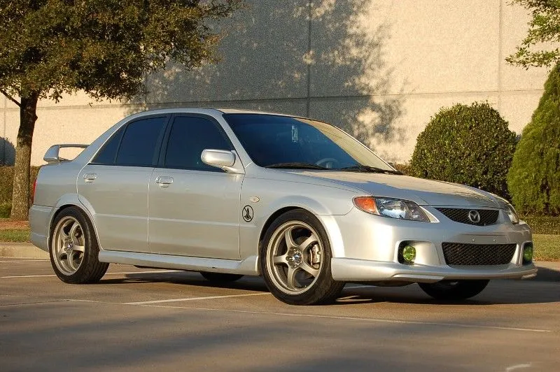

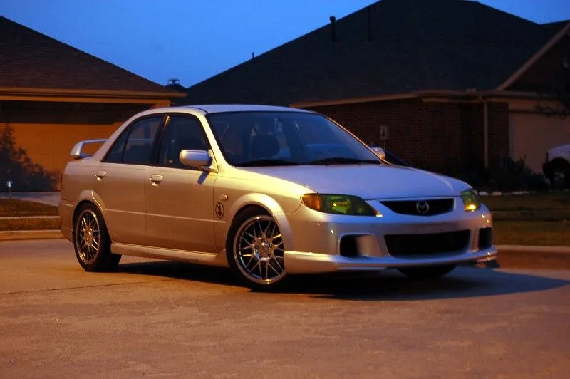

They'll definitely fit. I had some +43et 17x7 Ace Arius wheels w/ 215/45/17 tires on my car and I was dropped on espelir springs and still had enough clearance. You should be fine with the Ftd's. Here are the 17x8 +45et Ftd's on my car...nice wheels for the price. I also included a pic with the +43et wheels I had.
Looks nice! Thanks for the pics.
