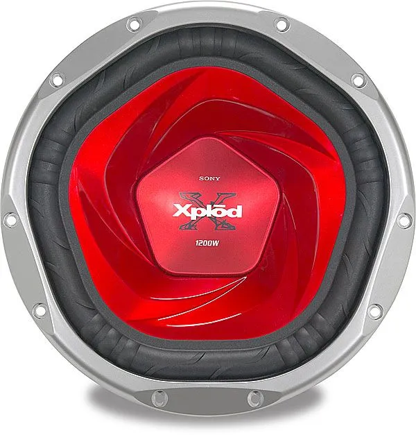

Well I finally broke down and got a new sub this weekend........I got the 10" Sony XS-L102P5 and I put it in a 0.75cu ft sealed enclosure.....and retained the stock amp. And holly cow what a night and day difference.... the sony hits HARD...I turned the bass setting down from +4 to +1 and the NF down from +4 to 0. Sounds awesome....I'm going to play with the settings on the HU and the amp later today when I can drive to a empty parking lot, I didn't want to distrub the neighboors this morning...
