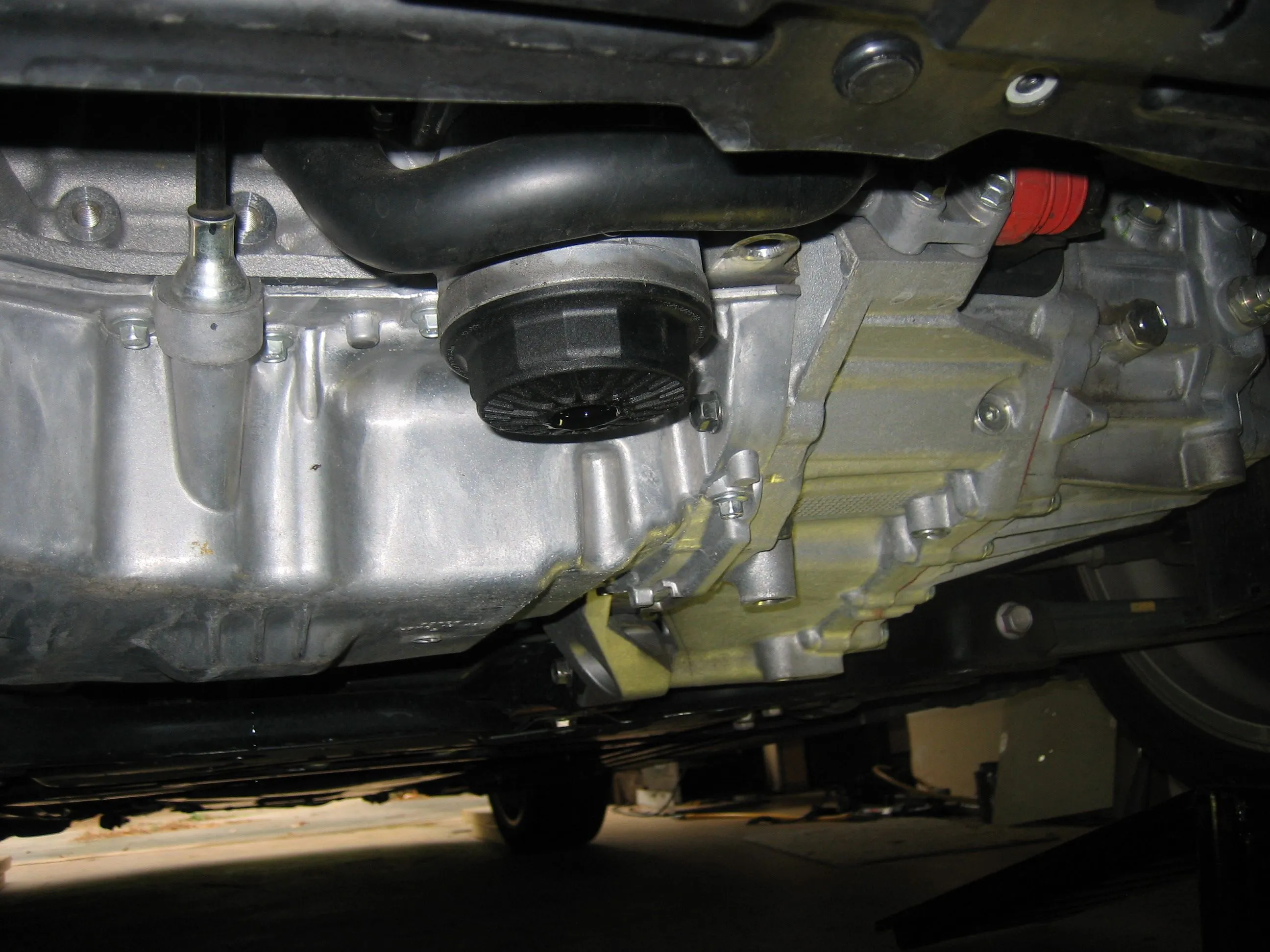

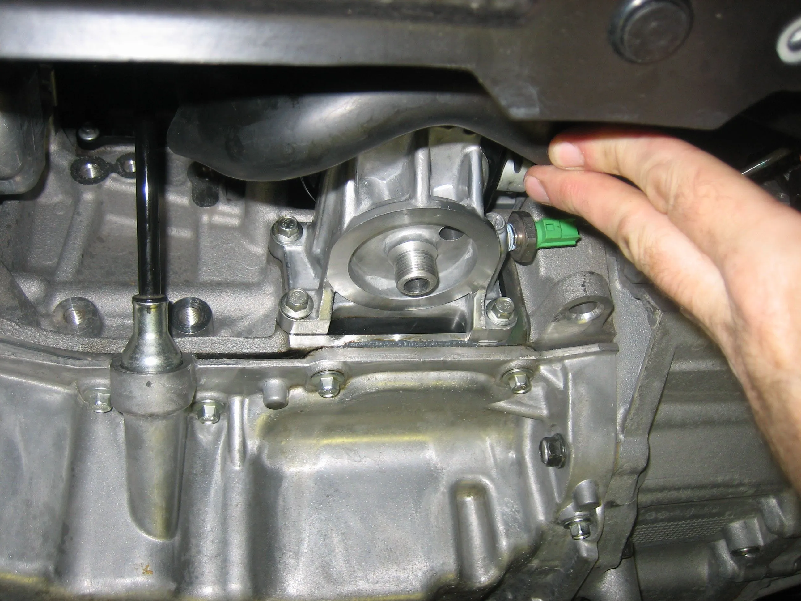

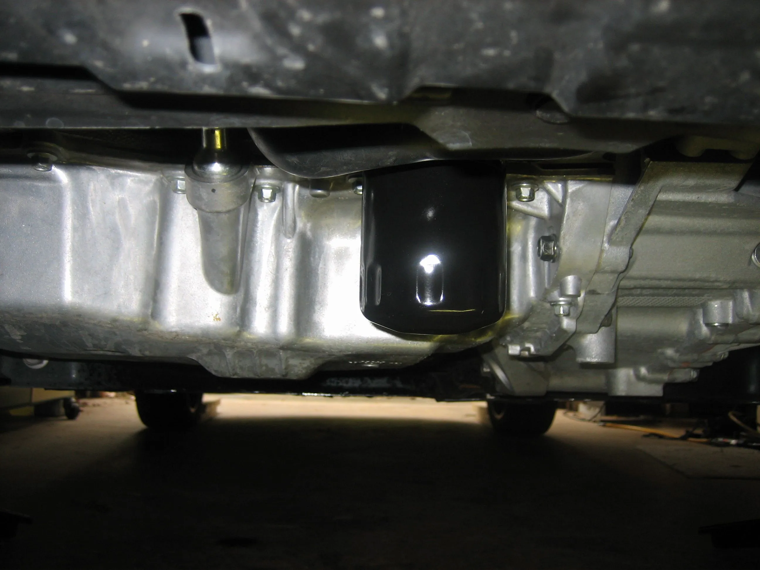

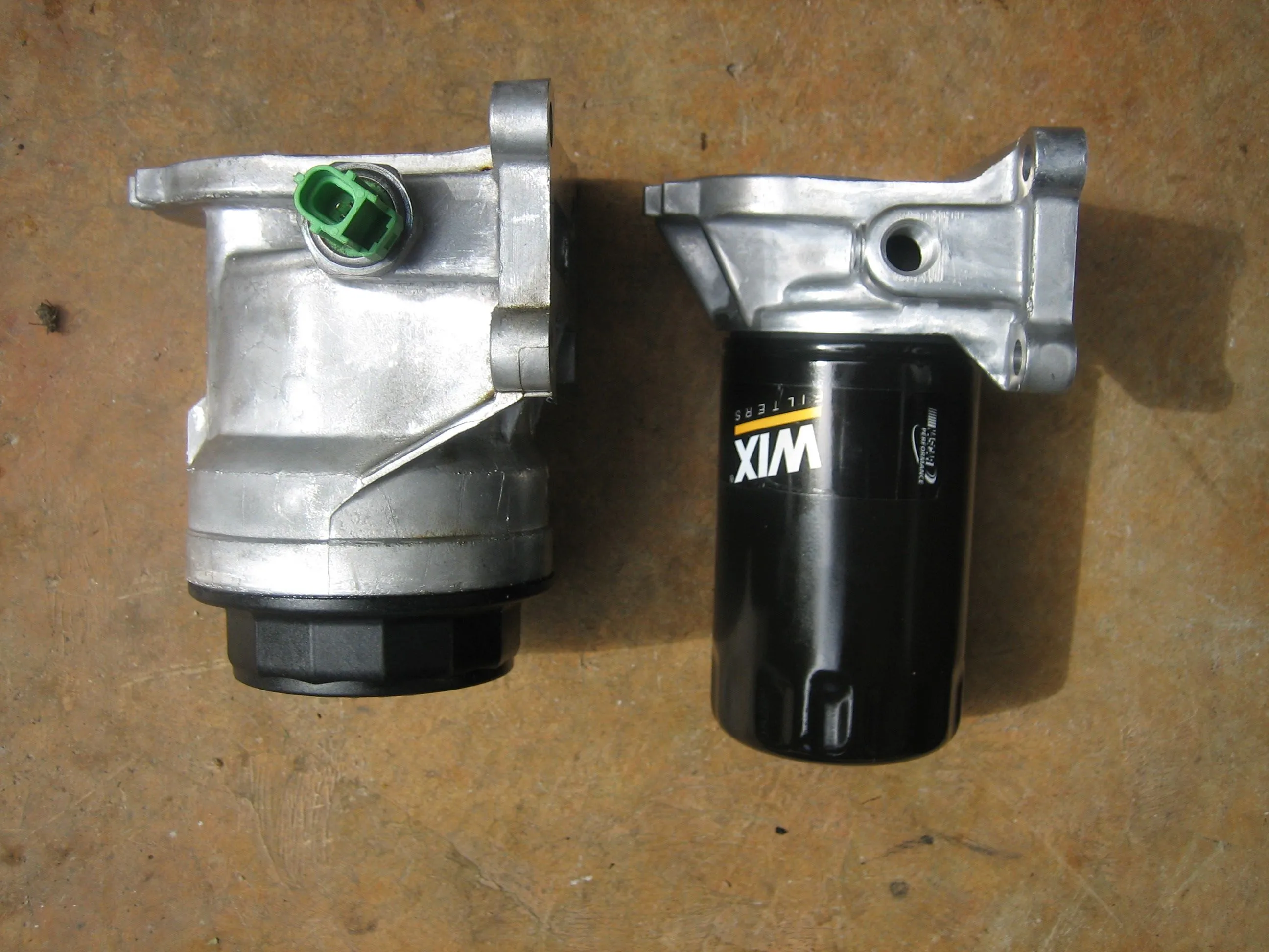

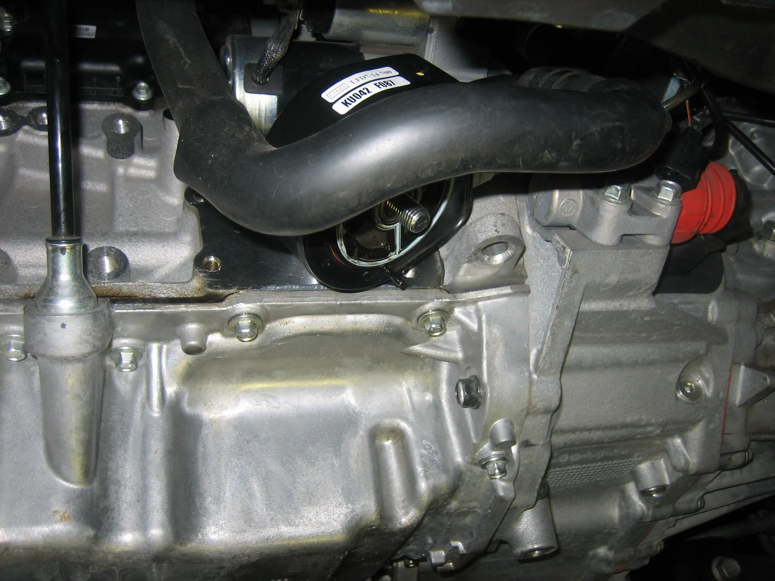

After starting this thread 8 pages ago, I finally installed my spin-on adapter today. The single screw in the top of the oil cooler is a PITA, but the install is straightforward. Anyone who says it is super-easy must own a regular 3, not the MS3 See the attached pictures in numerical order for:
Stock
Comparison using B3000 filter
Stock removed
Spin-on installed without filter
Filter installed
I do not recommend the Wix 51516 filter for the B3000. It is longer and very lightly touches the lower plastic shroud. The Tribute version is shorter and should not have this problem. I will switch to the Tribute version at the next oil change. It appears that with the short filter, you could reach through the hole in the shroud and change the filter without removing the shroud, although it would probably be a little messy. This combination took 6.5 quarts to fill to the top hole on the dipstick.
