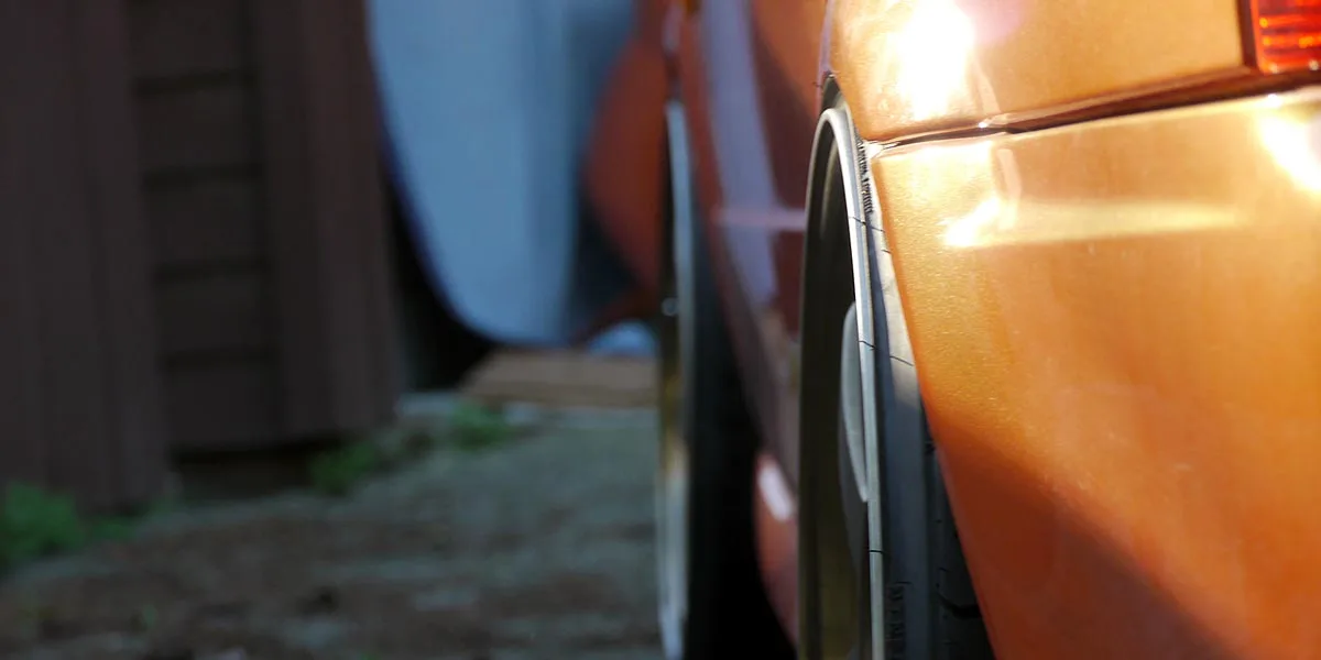

just a question, looks like the rear wheel is angled...not camber, but the other way, is it just the way the picture was taken?
it does look like there might be some toe-out... actually looks like a fair amount
it's the angle of the pic however you can fine tune toe by adjusting the later links. reduce or add. the bronze te37s arnt going to be my set up. just wanted to show everyone what is possible with the kit and over slotted combo. 20211_002.webp

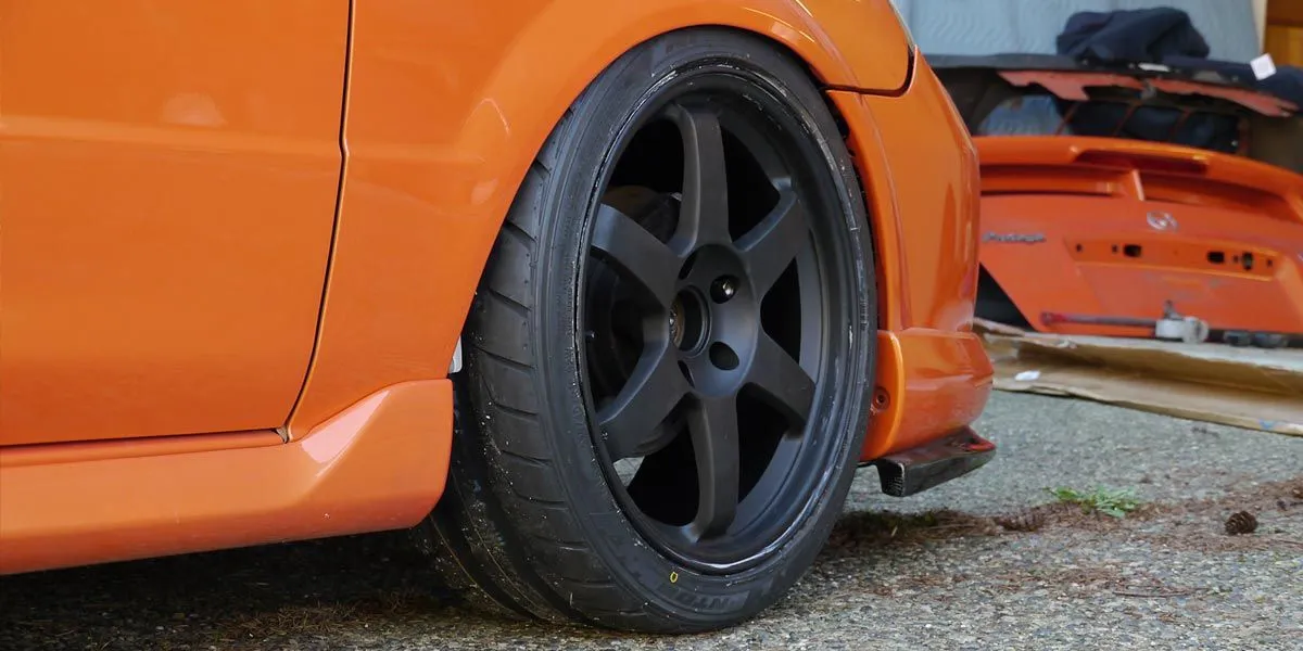

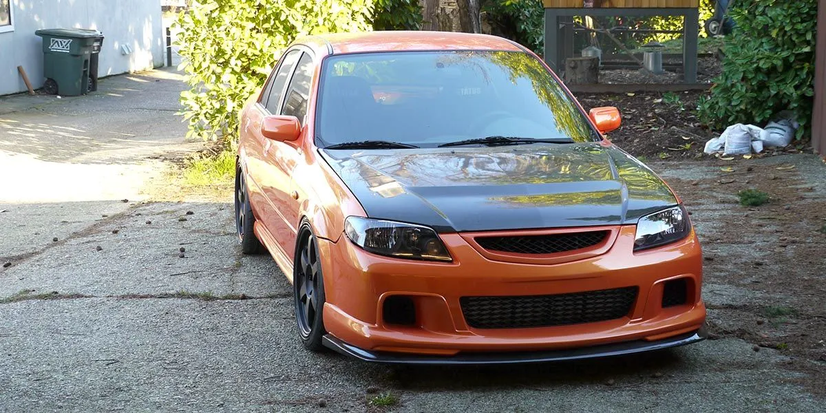

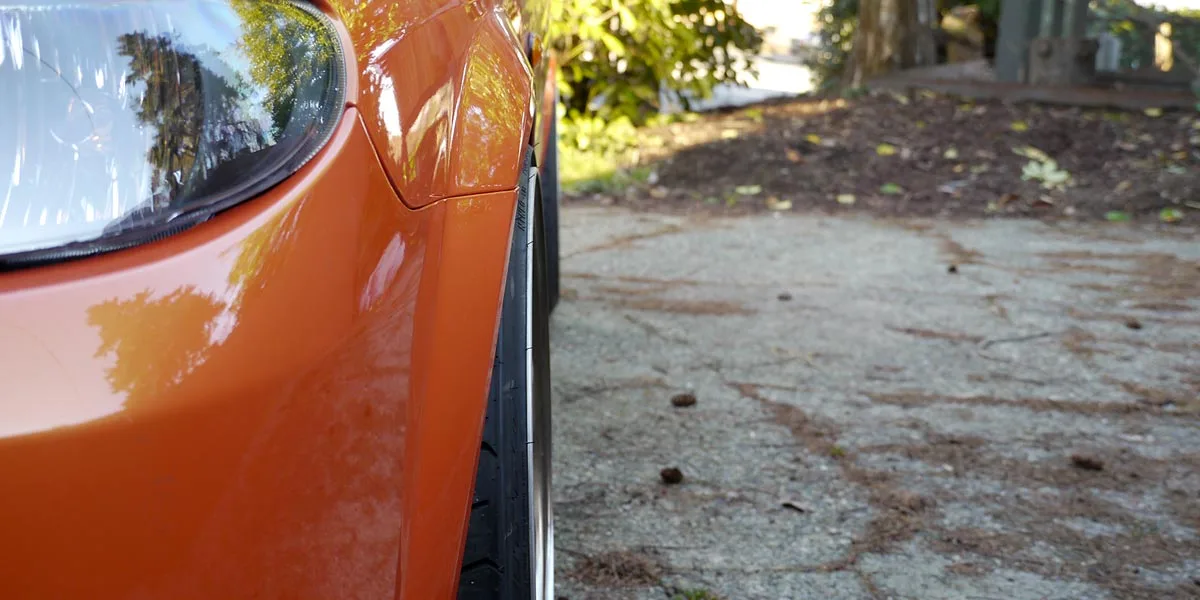

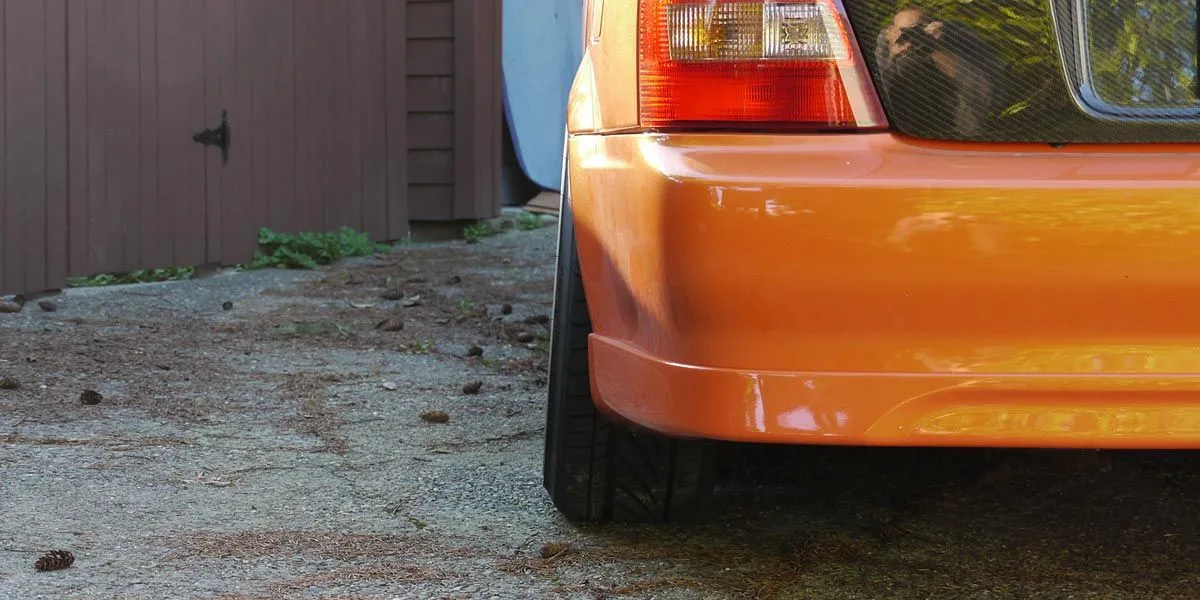

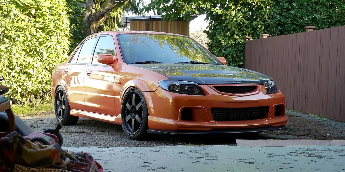

k here are new pics - two different fitments
current state of the spicy - still have some messing around to do with both sides.
one side is to show function - the other form - this was the first test run with new link kits and slotted coilovers.
function (still need to adjust camber so that i can lower it some bit)
front 18x8.5 +30
back 18x8.5 +30
form (front is way too high still but you get the idea)
front 18x8.5 +12 (with 10 mill spacers)
back 18x8.5 +7 (with 15 mill spacers)
