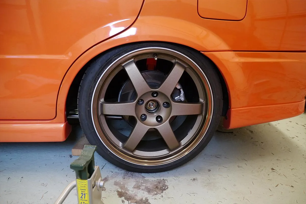

The rear fitment looks really good now and back in the right direction. Some of the earlier test shots and stretched look had me a little concerned..lol. Your back on track..keep it up it looks awesome. Looks so good...your convinving me more and more to get this suspension set up and wider wheels.

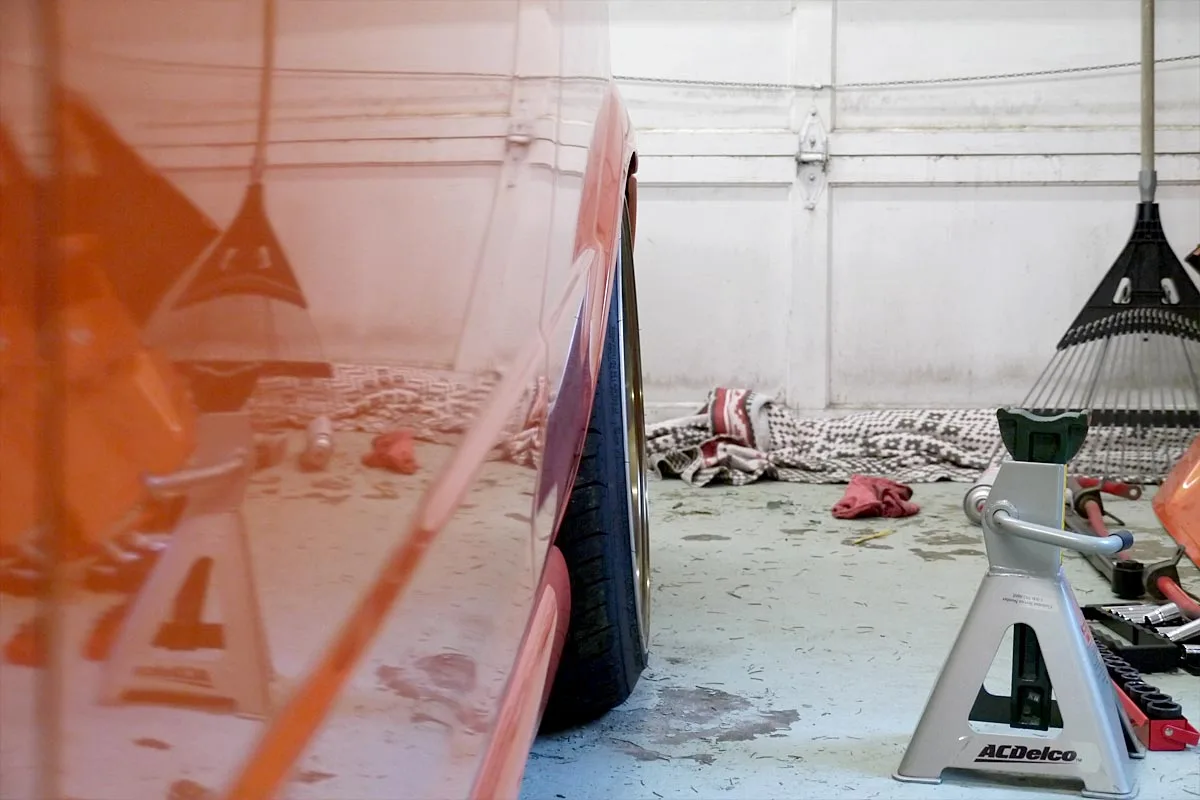

id say the camber is about equaled out right now. the link kit has allowed me to suck in the lower part of the knuckle considerably. the Ksport coilovers by themselves have some camber adjustment for the upper knuckle which is maxed at its most (- camber) location. on top of that i have camber bolts so i can further test the range of camber up top. the link kit how it is set now currently equals that (-camber) out by pulling the bottom of the wheel in. i can do that because the link kit is adjustable in length and pivot.
if i wanted i could keep the upper knuckle camber where it's at and increase the length of the links thus pushing the bottom of the wheel way out. then you would see tons of (-camber).
exaggerated depiction
all that said the wheel is about equal,which is what i wanted, not + or -. my goal is to tuck the tire and still have min (-camber). I haven't done an alignment yet but it seems about straight. there is still room for the strut/coilover to move inwards towards the wheel well. this means that i should be able to design a coilover with upper camber plates which will allow me to slide the whole strut towards the inside of the wheel well thus giving me way more range to play with. Especially if i relocate some of the break line components.
hope that helps

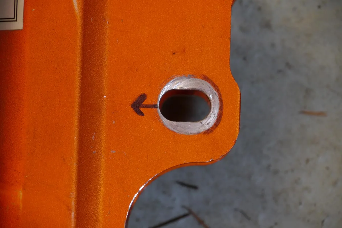

update, first 5 sets of links will be done soon then off to get sprayed. on the coilover front, i stripped out my whole rear sus in prep for coilover development. my Ksports or going to be turned into ginnies for a custom coilover set up. i'm over-slotting the rear collars for max camber adjustment and adding rear pillow ball mounts + camber plates. the goal is to see how much range i can get out of a custom suspension before working with a sus fabricator on the final build out. expect max height adjustment along with a very static spring rate. goal is to keep the body roll down to a min.

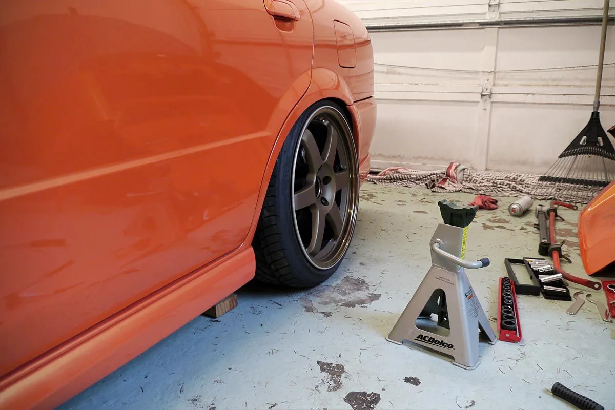

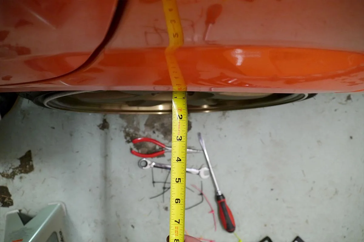

8.5+22 too small - co's are back and mounted. with the new set up 9.5 easy. rim tucking 8.5 +22 205 40 with s*** tons of room. lots of pics tomorrow. too much tease but stoked on the new set up. soo much range.
so the new links are in and test fit with the over slotted ksports - a great starting point for a new set up (TBD)
pictured set up 18x8.5 +22 (205 40s) - as you can see there is tons of room to mess with :)
