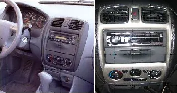

Just did 1st install on '02 P5 thanks to 1sty (kits/gear) and 2003newlyack (dash seperation) Time spent in car on install 30min! Also used the box from a 2000 Protege mined from junk yard $10 and it works/looks great! Finally, used Best Kit P/N BHA7902 and just pulled the blue PWR ANT pigtail and pin and stuck it back into pin 11 for the dim feature! Thanks again. Image shows the 2000 Protege Sedan vs the P5 (on right)
