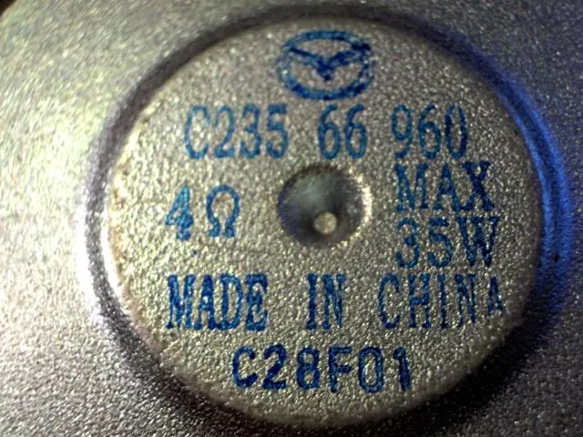

Just to keep everyone up to date, I just replace the front and back speaker. The front where replace with west coast custom by orion (WCC-570cx) and the rear where replace by Kenwood (KFC-C5780ie). Since the change the sound is a lot clearer and there has been and increase in the bass. The orignal speaker front and back are 5 x 7.
