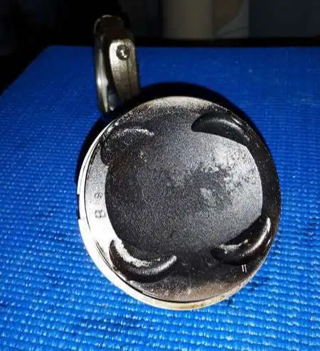

I'm just speculating but if your car is burning oil (like just about every P5) then you could have thick carbon buildup on your pistons.
If a piece of carbon breaks off and gets caught between the piston and spark plug, it could close the gap. That stuff is rock hard.
Maybe try and look down the sparkplug hole with a scope and see what your pistons look like.
