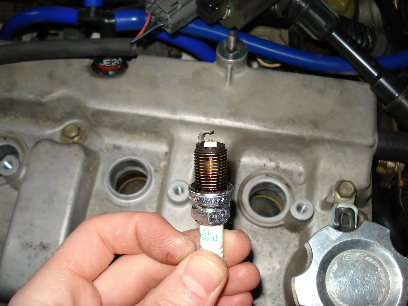

T Tzar177 Member Contributor Jan 22, 2007 #1 should plugs be this dirty and oily after only 2000-3000 miles? Attachments plug.webp 115.5 KB · Views: 276
B B1GHAM Member : 03.5 Mazdaspeed Protege Laser Blue Mica #2729 Jan 22, 2007 #2 that sparkplug actually looks very clean. theres no buildup rust or colored residue. Keep in mind that a LITTLE bit of dirt is normal, as you are technically setting off mini controlled explosions in the combustion chamber.

K Kansei Banned Jan 22, 2007 #4 That's usually how my plugs look after a few thousand miles. Some carbon buildup is normal. I don't bother with the iridium plugs on my car though because they don't really seem to last much longer and cost a hell of a lot more.

T Tzar177 Member Contributor Jan 22, 2007 #5 what will happen if the gap is too small on a N/A setup?
K Kansei Banned Jan 22, 2007 #6 did you measure the gap or does it just look small? I know you aren't supposed to regap the iridium plugs though..

T Tzar177 Member Contributor Jan 22, 2007 #7 Kansei said: did you measure the gap or does it just look small? I know you aren't supposed to regap the iridium plugs though.. Click to expand... it says its not recommended to gap iridiums....but i decreased the gap just a bit. there are about .037 now from .044

B BigB Member : 2001 Mazda MP3 #60 Jan 22, 2007 #8 Those plugs look pristine. BTW NGK Coppers work just fine in our cars for 1/4 the price of the Iridiums. BKR6E-11

B BigB Member : 2001 Mazda MP3 #60 Jan 22, 2007 #10 Kansei said: ^^ or ZFR6F-11 Click to expand... There's not much difference between the ZFRs and the BKRs. I have found though, that the BKRs are much easier to find.
