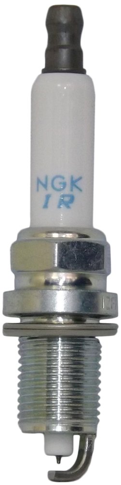

I found some compatible plugs and instructions here: http://www.paulstravelpictures.com/...gine-Spark-Plugs-Replacement-Guide/index.html Denso FC20HPR8 (Mazda OEM # PE02-18-110), NGK DILKAR7F8 (Mazda # PE01-18110), NGK (3811) ILTR5A-13G, Pulstar ef1i, and Autolite XP5364.
There appears to be a noticeable physical difference between OEM spec and after market spec compatible plugs.
OEM:
And the NGK 3811 going for $12:
I think your photo may be wrong. These are the ones that came up for me when I searched for ngk iridium plugs for the cx-5. They look much closer to oem
I'm having trouble seeing how you think these are close to the OEM plugs. Don't the OEM plugs have the arc suspended between two "pin style" electrodes? The NKG plugs do not have this feature.
I wouldn't hesitate to run compatible aftermarket plugs but ONLY if they were the functional equivalent. That would include having two "pin style" electrodes.
We're both right. Apparently the NGK has an OEM replacement and 2 compatible aftermarket ones. The aftermarket I posted (smooth ceramic) and the one you posted (threaded ceramic) are interchangeable. Just not sure which is the newer version. Source: http://www.sparkplugauto.com/ngk/la...rk-plug.html?gclid=COiMk7C77ckCFYhffgod95gD3g

Well they may be replacing part numbers but I still think the photo you posted is just a stock photo and not one of the actual plug needed. Here is a picture that I found for the ngk iridium plugs according to their website. Part number ILKAR7L11 and reference number 94124.

both the plug for my 2.p0op and 2.5 have a plug with two points on them. That NGK does not have a lower point. As the plug wears that point gets smaller
