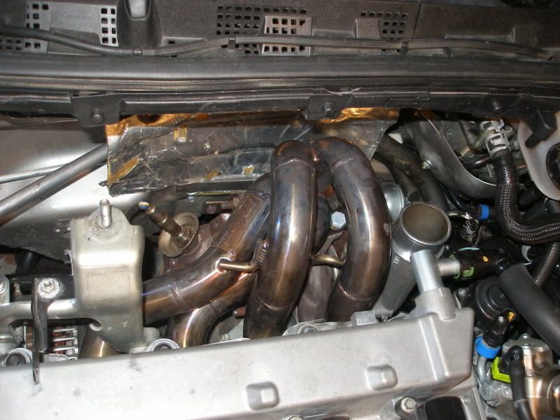

I wonder if the PG exhaust manifold would have fitment issues with that pipe and the way it turns toward the hot side of the turbo over the engine. Not to mention the effects of a hot manifold right next to a silicone elbow.
1) Oh wow it looks close. The intercooler pipe is raised a good bit though. I could probably either raise the pipe higher into the now hollow hood scoop area or bend a new pipe that goes straight towards the front and not towards the passanger side at all.
2)That manifold looks like crap. Is it old? Its dark and stained like it has 50,000 on it already.
3)Laloosh I have a very good feeling that the CP-E intake will not fit with the Turbo XS FMIC. My IC pipe is quite near the shifter weight which I know is occupied by the CP-E.
That is a photo of the prototype, raw, unfinished pipe. But yeah, i think if that manifold is in your future, this IC may be a problem.
