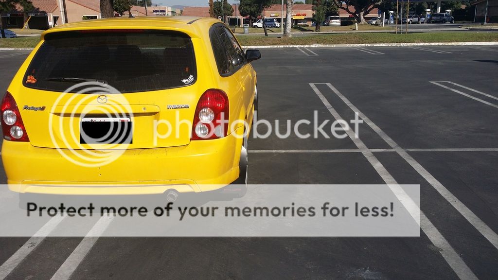

Not sure what happened to the photos. Up front they are screwed into the plastic liners on the wheel well. Out back is the same story. Use some self-tapping screws and you're set. Just make sure they are high enough off the ground (esp out back) otherwise anytime you back up there's a chance your wheel could literally run them over and pull them from the wheel well (it happened to me!).

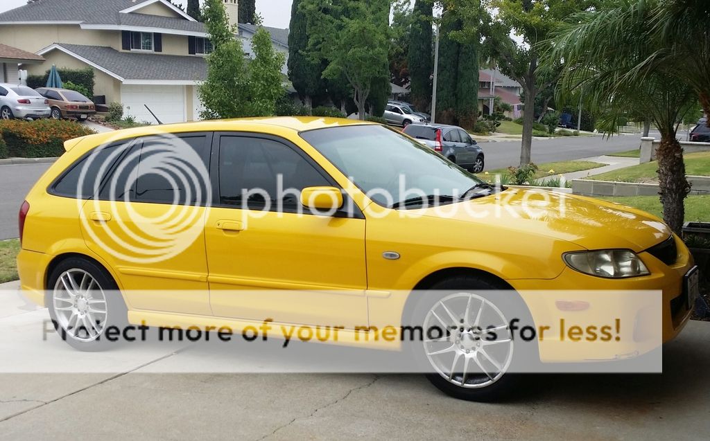

2003 P5 Yellow (Ya, I know it is a little beat up. Bought it second hand like this.)
This is without them...

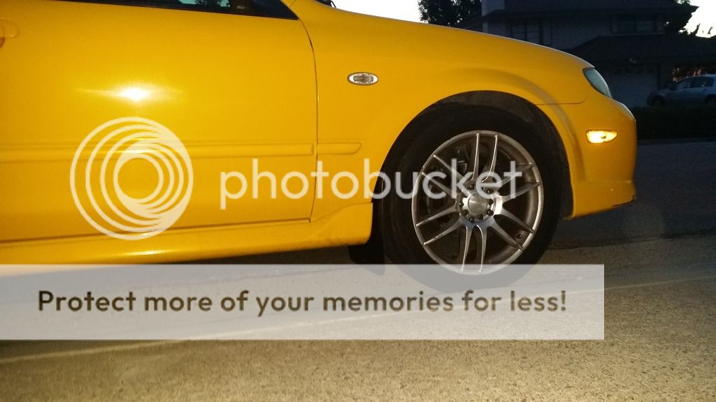

Just a couple photos of the front right side.

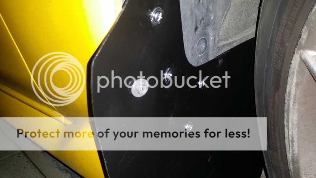

Here are the spots I mounted mine. I used 4 expansion anchors that are made for hollow dry wall. The entire anchor is metal including the part that expands.
I also used the one screw that is on the edge of the fender already. I will probably paint the anchors black to match.

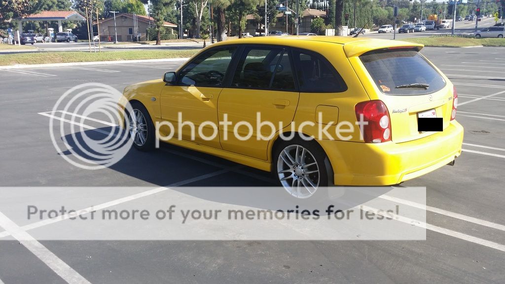

Here is the entire car with them installed. Looks nice to me. :)
