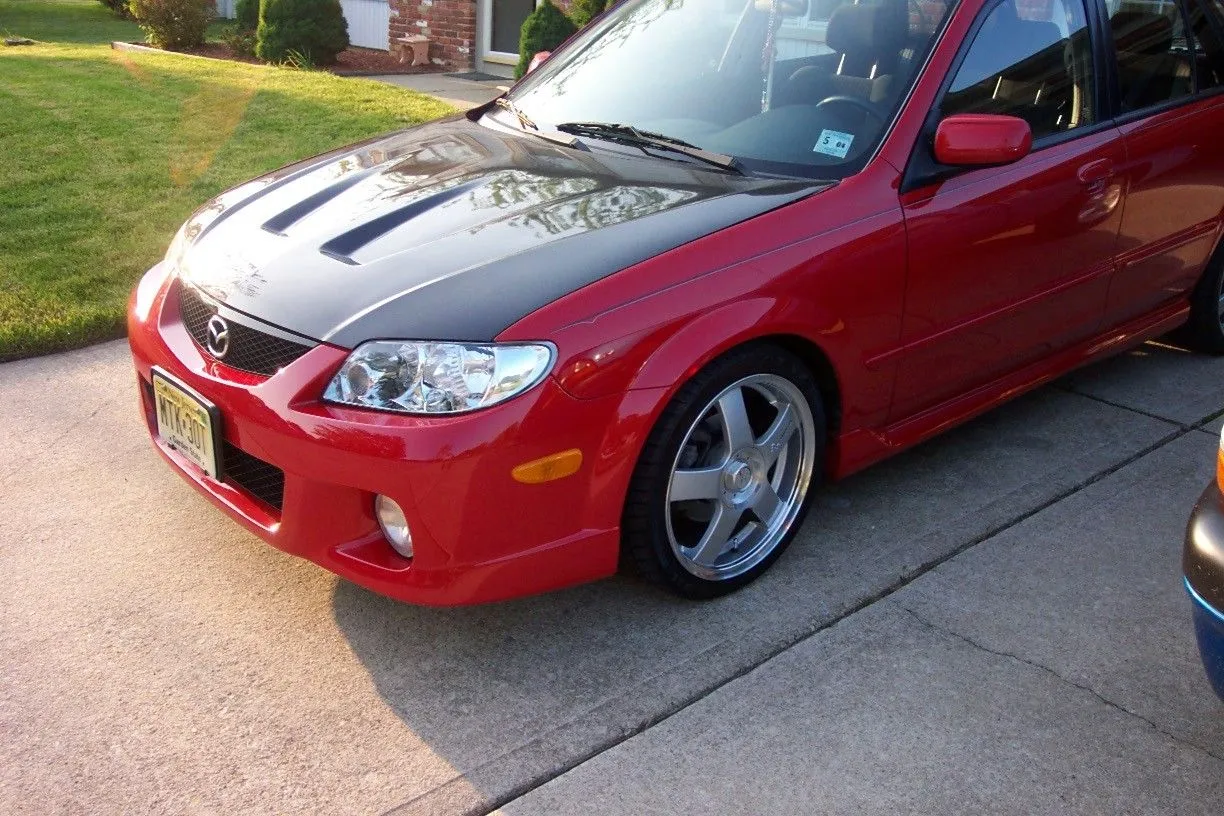

Whats up. Im running 17*7 rims with my MP5 with eibach springs and absolutely no rubbing at all. I also had times with 3 people in the car also and no rubbing. I have the RH evo C5'S. Heres a pic of them with Eibachs. Hope this helps.
Jason:D
very nice, tight ride. rishie says 40 won't fit. i trust him but a lot of people, like you, are running 40 w/o a problem. anybody else, more pics please.
