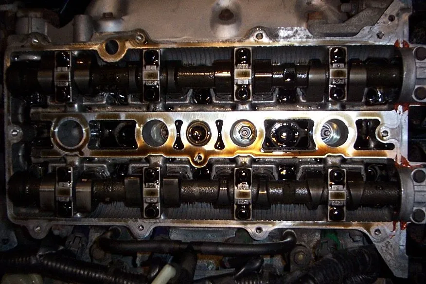

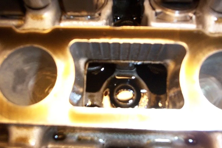

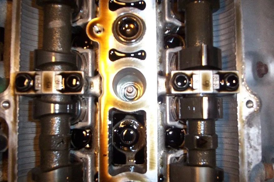

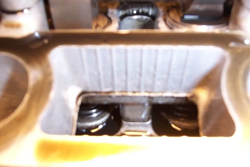

Not sure how well the photo's came out, but after running the car and getting it hot I pulled the valve cover. There seems to be oil pooling around the valves. Any ideas of where the correct drain path is for this fluid? Or is this normal?

I checked the car again this morning. Looks like the small pools of oil around the valves are about the same height- so I am assuming this is normal.
But, gozz - you said Intake and Exhaust valve seals are different? Do you know how? I just checked onlinemazdaparts.com and they are listing different prices for intake and exhaust seals. But I bought a full head gasket kit from Rock Auto (Felpro seals) and they were all in the same bag?
I trust the shop I took my head too, as they have done other engine work for my family and some of my co-workers and seem to be pretty good. But now I am starting to question the seals. Can anyone tell me the differences?
