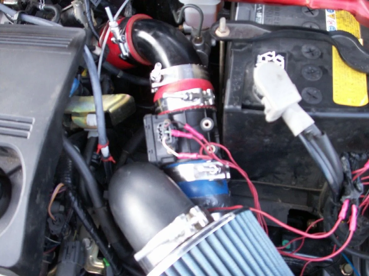

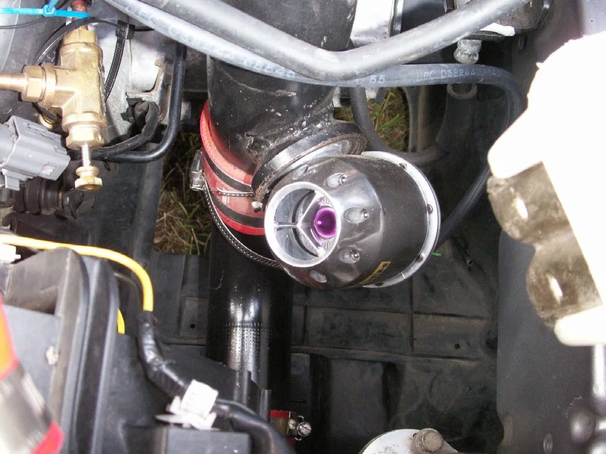

I have a relocated MAF and BOV (SSQV). Coming from the throttle body, you should have your MAF no more than about 12" away. On mine, I have a 90 elbow off the TB and then the MAF.
Your BOV should be located about another 8 to 12" before the MAF on the cold pipe. Optionally, you can put the BOV on the hot pipe.
Here are some pics. Hope this helps.
