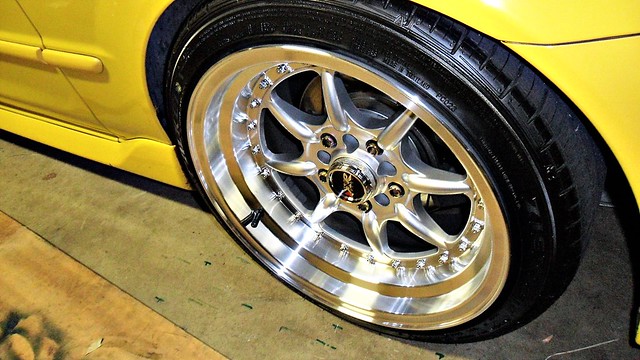

here is a 205/40 on a 16x8 wheel. mild stretch..
the rest
