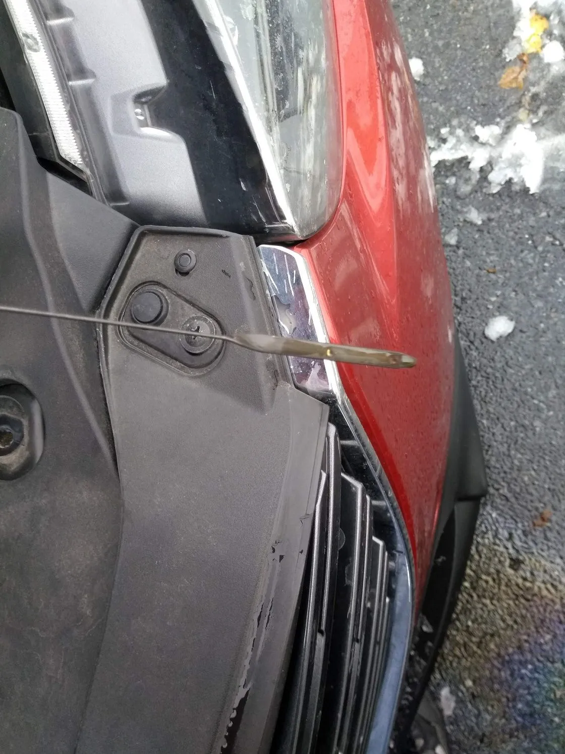

Why could dealers never get this right? It's the only reason why I always do my own oil changes. Is it too much to check the level on the stick? When I had mine in for a leak it was a half quart over full courtesy of a Gold Cup Mazda dealership!
attachment.php
Wow thats serious overfill! It seems more than a half quart overfill!
They must put in 6 quarts of some cheap bulk oil instead of 5!

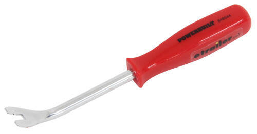

Drop the entire front cover. It's clips and 10mm screws. It will be readily visible if you have problem or not.
Tip for putting back on: The front side has notches that will hold the front side on while you push in the pins on the rear. I do the 10mm bolts last. A cordless screwdriver speeds up the process.
EDIT: I need to find a better graphic as a lot of the push pins are on the lower side of the graphic out of view. It will be obvious when you look at it. Easier to get off on something like Rhino Ramps as well.
Appreciate it. Thank you.
Oh so same panel I removed when I did the transmission fluid? I will definitely take a closer look and see what's there.
Correct. That latter tool might not be needed but I find using that in combination with something like the cheap $2 HF pick tool gets those fasteners out a lot easier.
