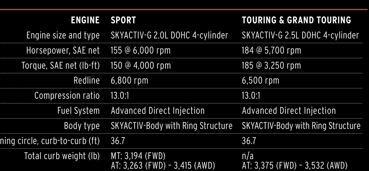

Yes true. Pre facelifted FWD Mazda 6, CX5 is 3200lb-3400lb. At this weight, and without the driveline loss inducing, heavy AWD system to lug around behind you, these cars can be quick off the line.

Here are the weight differences for the ‘15 CX-5 (US Market)
