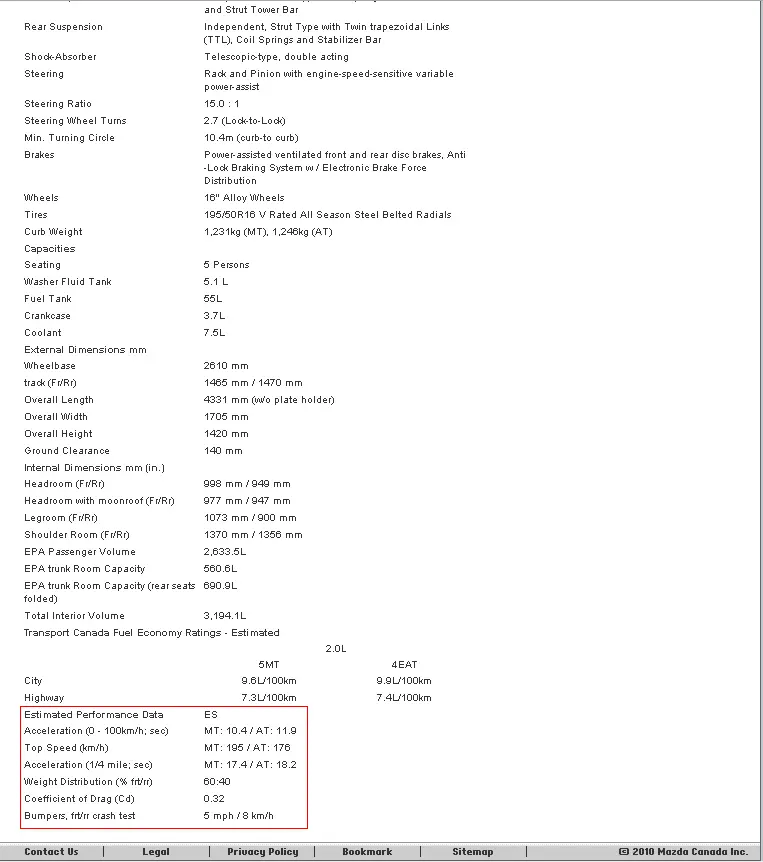

For what it's worth, Mazda Canada posts the 0-100km/h time as 10.4s for the 2003 Protege 5 manual transmission.
www.mazda.ca has vehicle archives going back to 2003 (from the menu bar, point to Vehicles > Archives). Original owners manuals are also available in PDF (under Parts and Service > Owner Info > Owner's Manuals)
A portion of it below:
attachment.php
