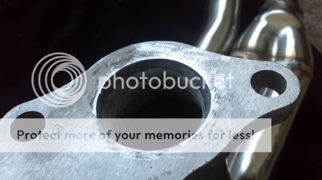

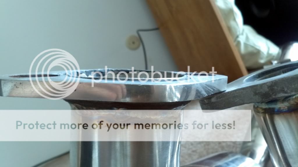

Noticed that much of the fitment problem at the header outlet/HFCP inlet was due to the 2.5" piping at the inlet sticking past the flange and hitting the smaller flange at the outlet of the header
So I filled the gap with metal filler and then ground it down
Then I painted it with High Temp paint after prepping the surface with a scotch brite

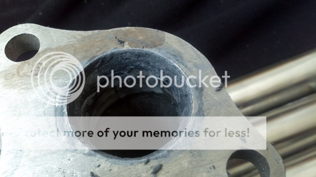

First I filled the gaps with metal filler and ground the pipe edges down a bit
Then added liberal amounts of metal filler and let er dry
Then ground it all to a smooth angle
Not sure how the metal filler is going to hold up to the high temps but it is supposed to harden to metal strength, I mean this stuff was just as tough to grind down as the metal was. Anyway it was better than leaving it and worth the try to see what happens.

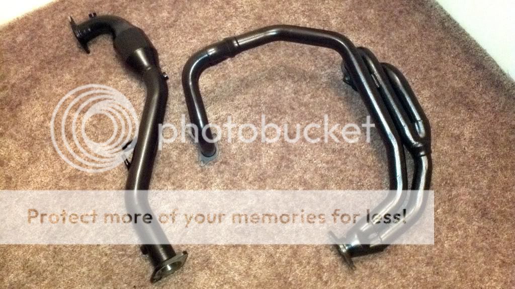

Regretting not taking as much time to scuff the surface of the header before painting, as I was taking it off the hanger the hooked aprt snapped from me spinning it earlier as I was painting it ... my thumb grabbed part of the painted area to keep it from falling and slipped a big spot of paint right off
Maybe Ill see how much I can force off and re-do them while I wait for the wrap to get here ... *shakes head at stupid-ness of cutting corners*
Quick test fit with the paint dired for a couple days and wow such a better fit. Not sure why they thought it was ok to send the pipe/flange out like that but w/e
And the whole shot

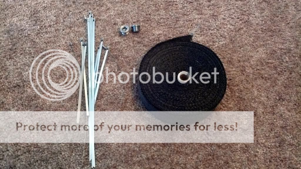

To order or not to order wrap coating spray...
You an also see my wrap estimation skills leave something to be desired
