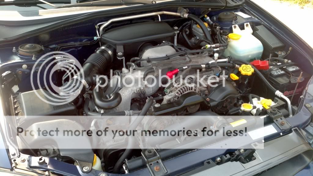

Did a fuel system cleaning today at work. Hand cleaned all the carbon out of the throttle body (Man was that dirty), did the intake drip into booster line, and finished up with injector cleaner in with the fuel.
Car had a hard time taking all the cleaner in, idled hard and almost died a couple times, thats never happened to me before on any car Ive done it on, but after taking in about half the can and filling the store with a rotten egg smell, my suspicions are confirmed that my cat is pretty clogged. Need to finished off the exhaust and get the header and HFC pipe to eliminate that old cat. But first I need to get a timing belt kit and a winter wheel/tire setup.

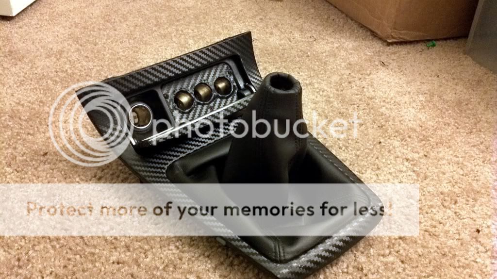

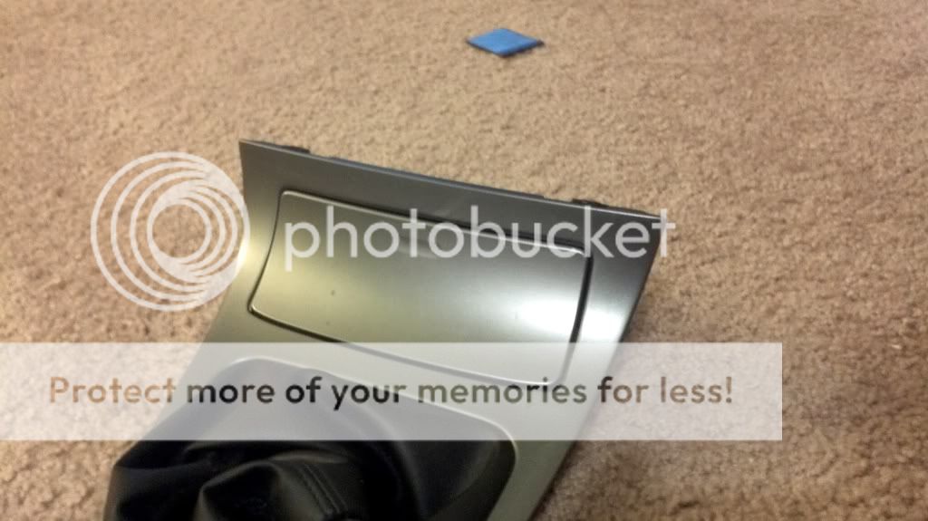

Decided to add a few more accessory outlets, so I got all my mod stuff out and went to town ...
What doo we have here?
...Oh hello
Came out pretty good, things could have been a bit cleaner and aligned properly but oh well
All I need is to figure out how to wire it in. Im thinking I can wire it into the stock plug. By assuming that the red and black wires coming out of the plug are the main power wires (red being positive and black being negative) I can wire the the outlets into there (black wire with white stripe being positive and plain black being negative). Will this work out??
Alright so I got the shifter trim piece wired up and back in place. First, the little red light was distractingly bright and the faceplate to the three accessory outlets I added popped the glue I used to hold it down since its under a bit of tension. So I took it back out, added two small screws to hold the face plate in, not a clean looking as before but now it will never come loose. And added a couple coats of niteshades to the bulb to hopefully dim it down a bit ... then got bored and well ...

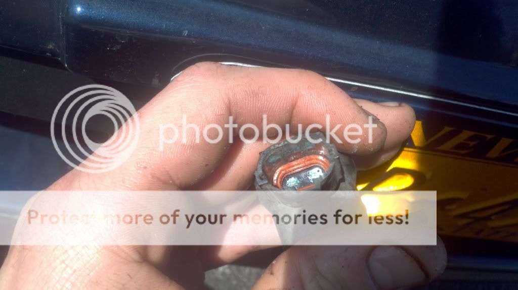

Also went to inspect my "chirp-er" when you lock the doors cuz it sounded like it was dying lately, and when I pulled the plug I noticed this...
The prongs corroded out into the plug...gotta fix that
Fixed my broken "chrip" unit
So when you dont have solder, use hot glue lol...
Sealed it up...
Installed it...
And proof:
