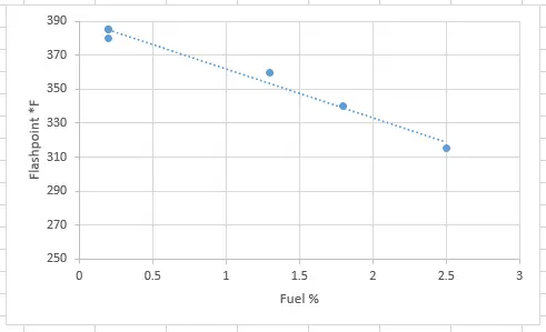

For instance, I was looking at the correlation between Fuel%, Flashpoint and Viscosity (assuming they are all affected by Dilution). No conclusions, just looking at it and wondering if some oils might be less susceptible to dilution, or if the timing of topping off the oil affects it (1/2 quart soon before the next oil change could bump the numbers.)
I'm not entirely sold on this point. Most UOAs I've seen show a correlation between flashpoint and fuel dilution. For instance, here is a graph just from my experience. Trace results were given a value of 0.2.

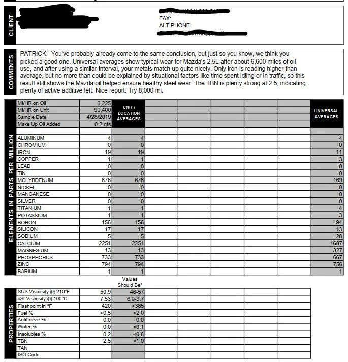

Just got my first UOA after the last oil change at ~90K miles, with about ~6K on the last fill of Mazda Moly oil. Looks like a pretty excellent report, and they suggest going 8K miles next time!
attachment.php
attachment.php
One can always tell from a UOA report that if the Molybdenum content is very high at ~650+, it must be from Mazda moly oil.
