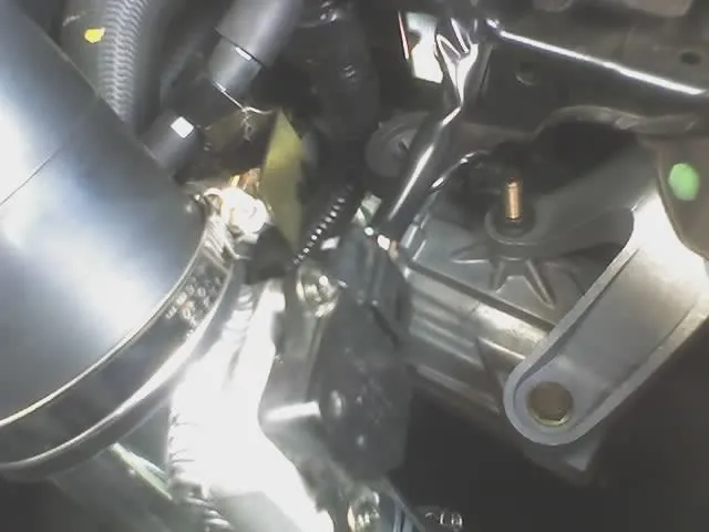

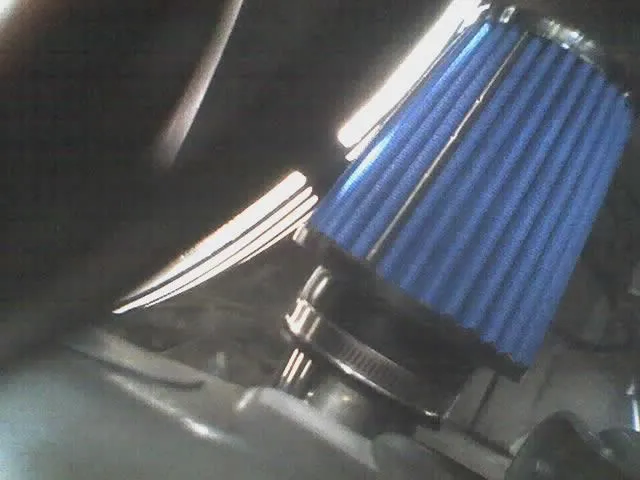

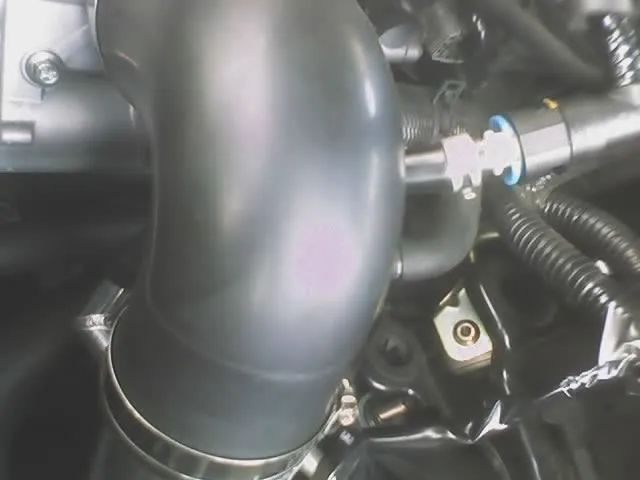

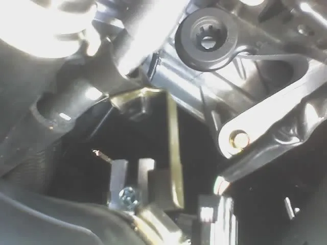

ok, here are my pics. all thats connected is the breather hose and MAF onto the intake. I don't know what the third one is supposed to be or what it looks like. You can also see how close my filter is too. The U bracket on the first pipe is being used to hold a hose in place. We took off that bronze piece and attached it to the bracket and attached it to the original hose it was holding. I dunno what else to say except I need to find a way to get my filter away from that vent.

Pic 1: That's your throttle body. The wires going to it are what controls the opening and closing of your throttle plates. Not a sensor.
Pic 2: That's your PCV fresh air hose. Also not a sensor.
Pic 3: That's your MAF sensor.
Pic 4: Air filter (but I'm sure you knew that). :D
Pic 5: Not exactly sure what's being pictured here. If it's the sensor with the "hose to nowhere", then that's your baro sensor.
