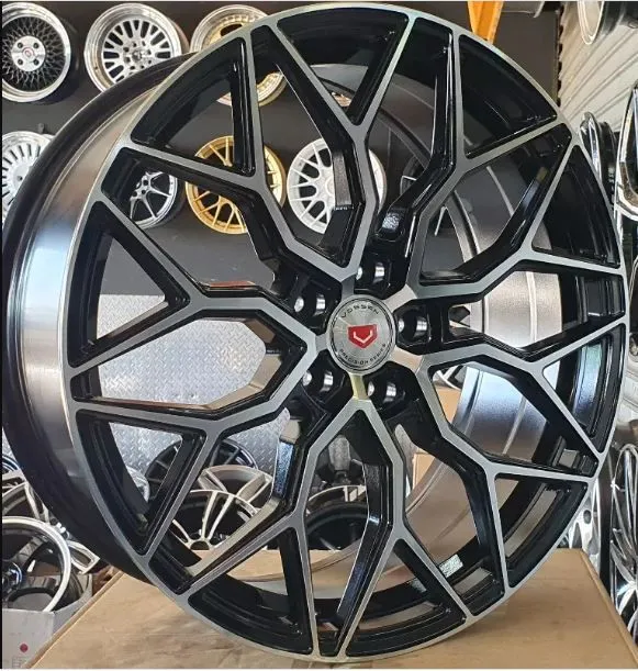

Hi guys
Just need some advice on theses rims, Vossen s17...20×8j et43 5.112/114pcd black machined.
I like the rim, but i was specifically wanting a 8.5J size. Just wanted to know if anyone can send a link to see how it will look with that size specifically. My idea was to use 255/45/20 tyres, but not sure if the rim will be too narrow.
Would appreciate your feedback and recommendations. Seeing the oem is et50 and a 7j rim, that means the rim will stand out 17mm out if i am correct.
Please send links of wheels fitted with 8j et43.
Link to site https://www.gumtree.co.za/a-car-tyr...4pcd-black-machined/1007571915740910272540709

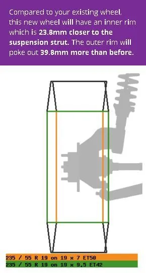

Orange is OEM, green is your proposed setup. Use the info in the purple section and grab a tape measure to make sure there are no clearance issues. Note that the tire is pretty stretched for a CUV - I would advise against turning too sharply with this setup as you are more likely to break the bead seal vs. a correctly sized tire.
This doesn't answer all of your questions, but it's a good place to start. Hopefully others running similar setups can chime in.
thanks for the info. I’ve decide to go with the 9.5j et42, I’m going to put on 255/50/19 tyres and sell my 235/55/19 tyres.
I’m not dropping the car at all. Can you confirm if it will rub perhaps and is there anyone that has a similar setup

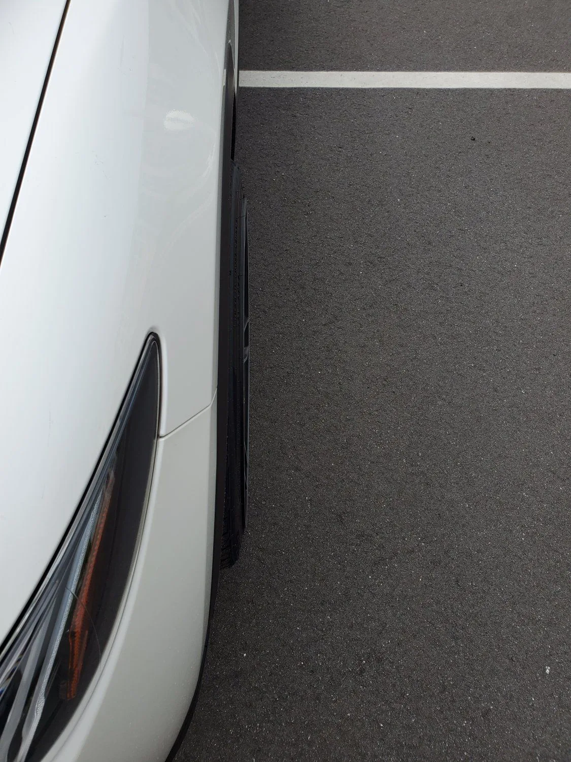

No idea if it would rub, but that's something you can check for yourself if you're willing to look. Using the info from the screenshot I posted, you can check the clearances you have on your own vehicle. Just use your camera to take some photos, like I did on my CX-9 here:
Old:
attachment.php
New:
attachment.php

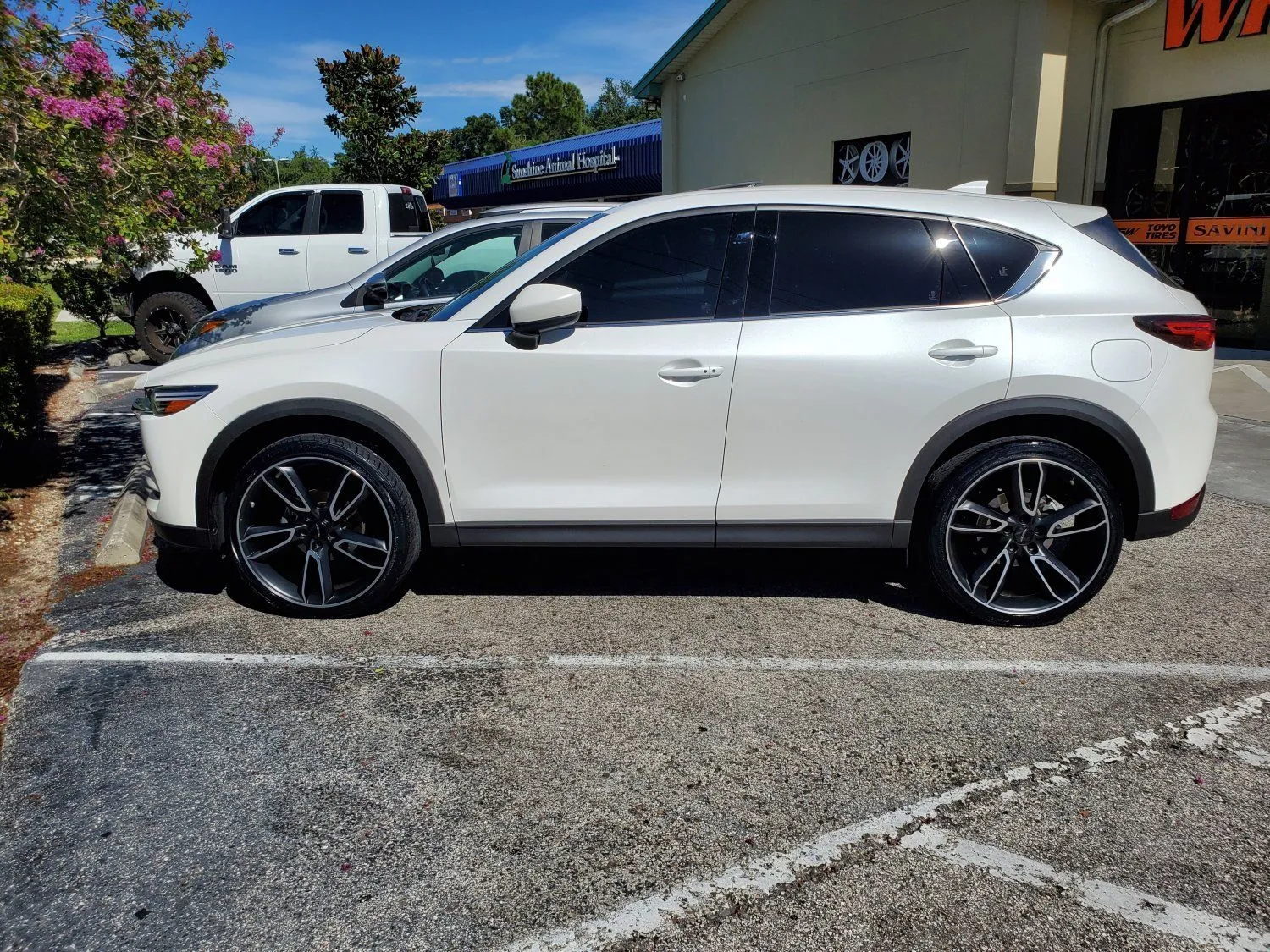

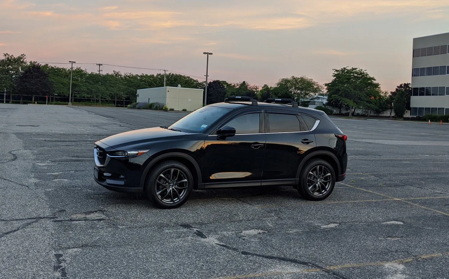

This is my 2020 CX-5.
Rims - Scorpio C-902 - Size - 22x10 - Tire size - 265/35-22
No cut no rub

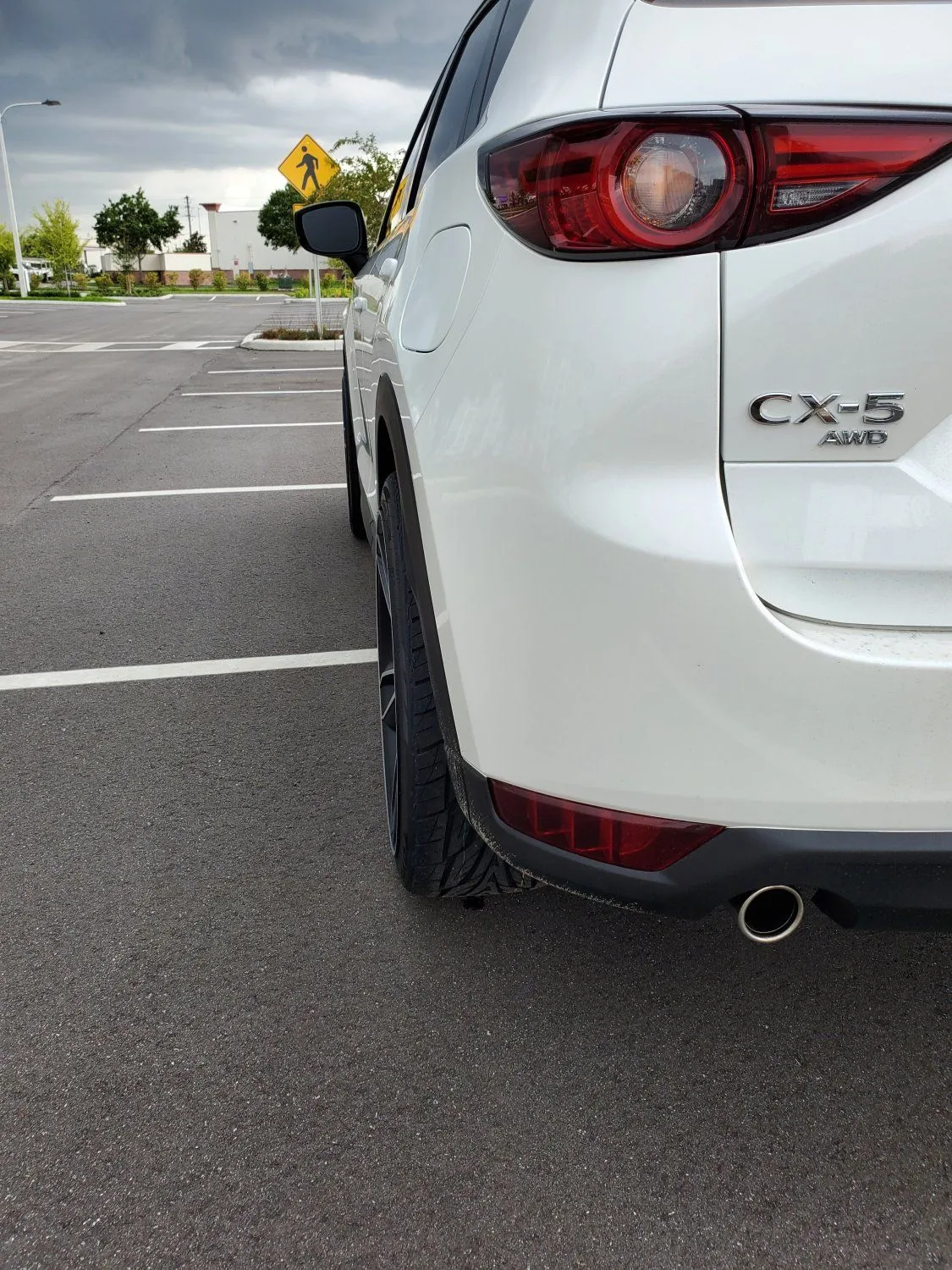

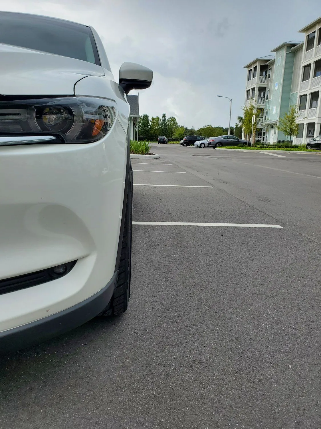

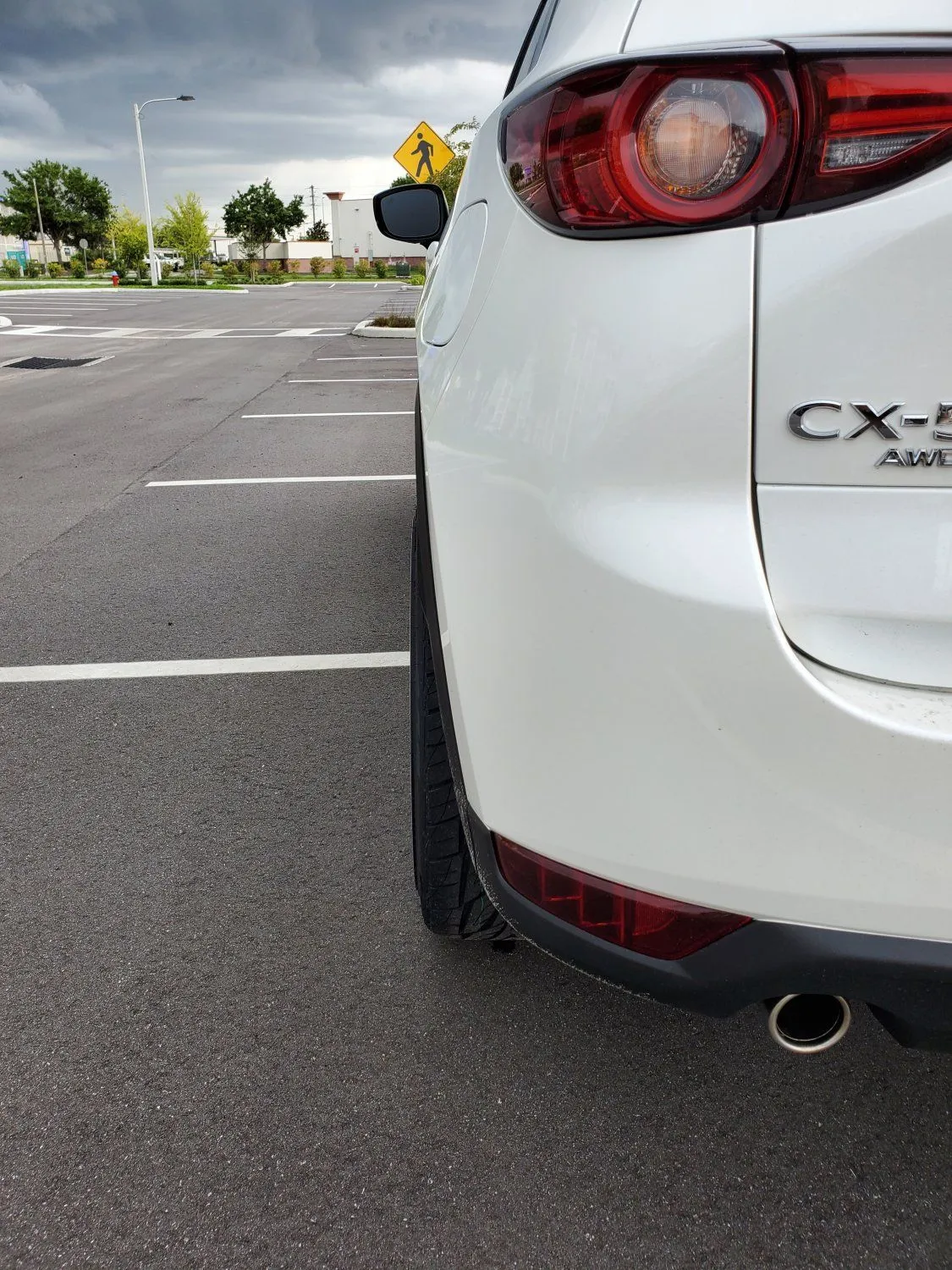

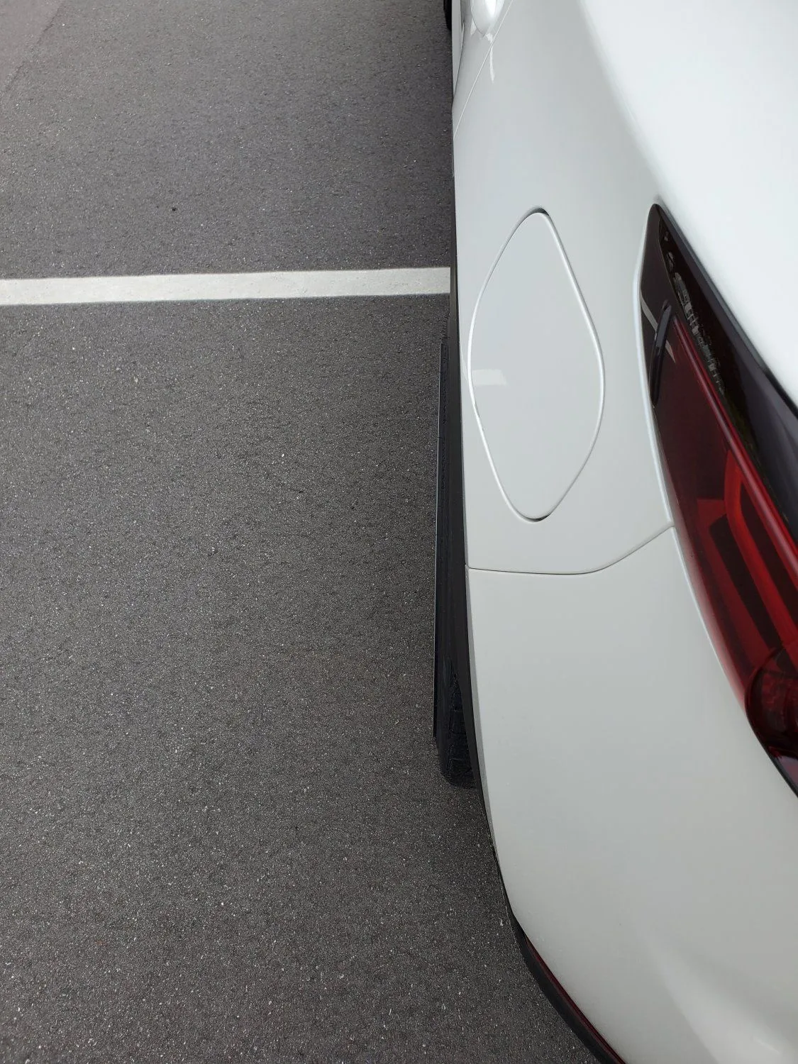

Nice I was wondering if I could run 10 inch wide all around and you were able to. What is the offset of the wheels and do you have any shots showing how much they stick out from the fenders?
They are a +45 offset... Please excuse the dirt as it just rained...

That looks great Thanks, I wasn't sure if the +45 would end up rubbing with a 10". Glad to hear yours doesn't rub. I was looking at +40 but it would end up sticking out too far. The +45 looks perfect.
Thanks! I was on pins and needles up until they were installed. Couldn't be happier with this choice.
