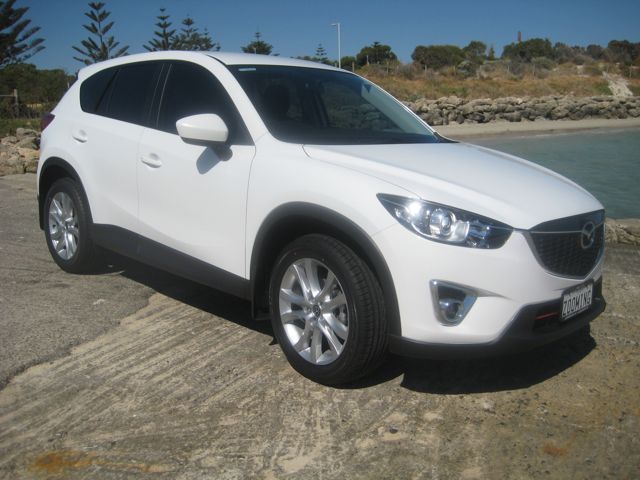

After reading heaps on here about upgrading the wheels on the CX5,I finally decided to change the OEM 17inch wheels to OEM Mazda6 2014 19 inch wheels.
There were a few reason's. I wanted 19's,but I didn't want the wheels to be too "showy", I liked the look/style/different silver colour of the Mazda6 19inch wheels.
I knew that the OEM Mazda6 wheels would have the same centre hub size,offset is only 45,width in Aust is 7 1/2,very little difference in total weight when fitting 235/55/19 tyres,and most important for me was that the speedo reading was virtually the same.
So here's a few pic's- hope you like the end results:
Very nice fitment u hav there . what are the specs for the OEM maz 6 19" ? is it the same as the 19" OEM cx 5 ? the wheels you have looks wider ???
Yes they are wider than OEM 19" CX5 wheels,and the offset is 45 compared to 50 on the CX5.

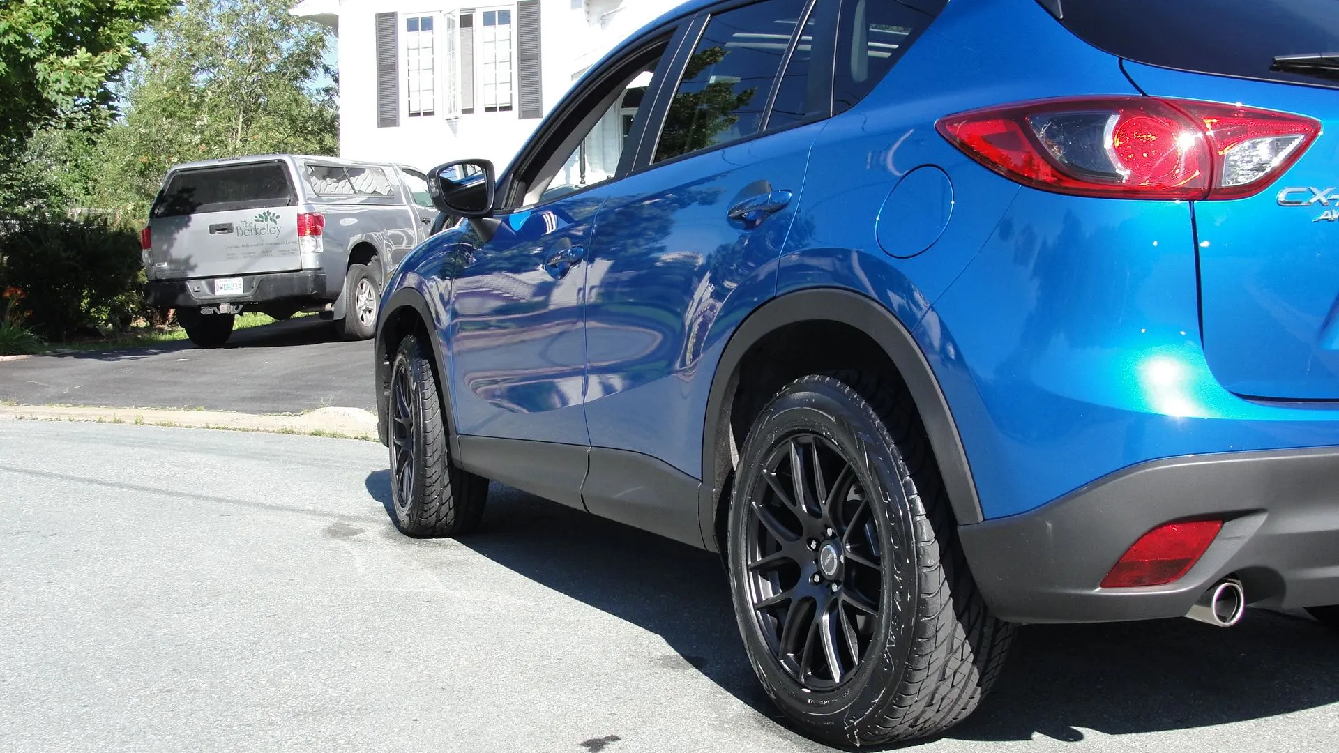

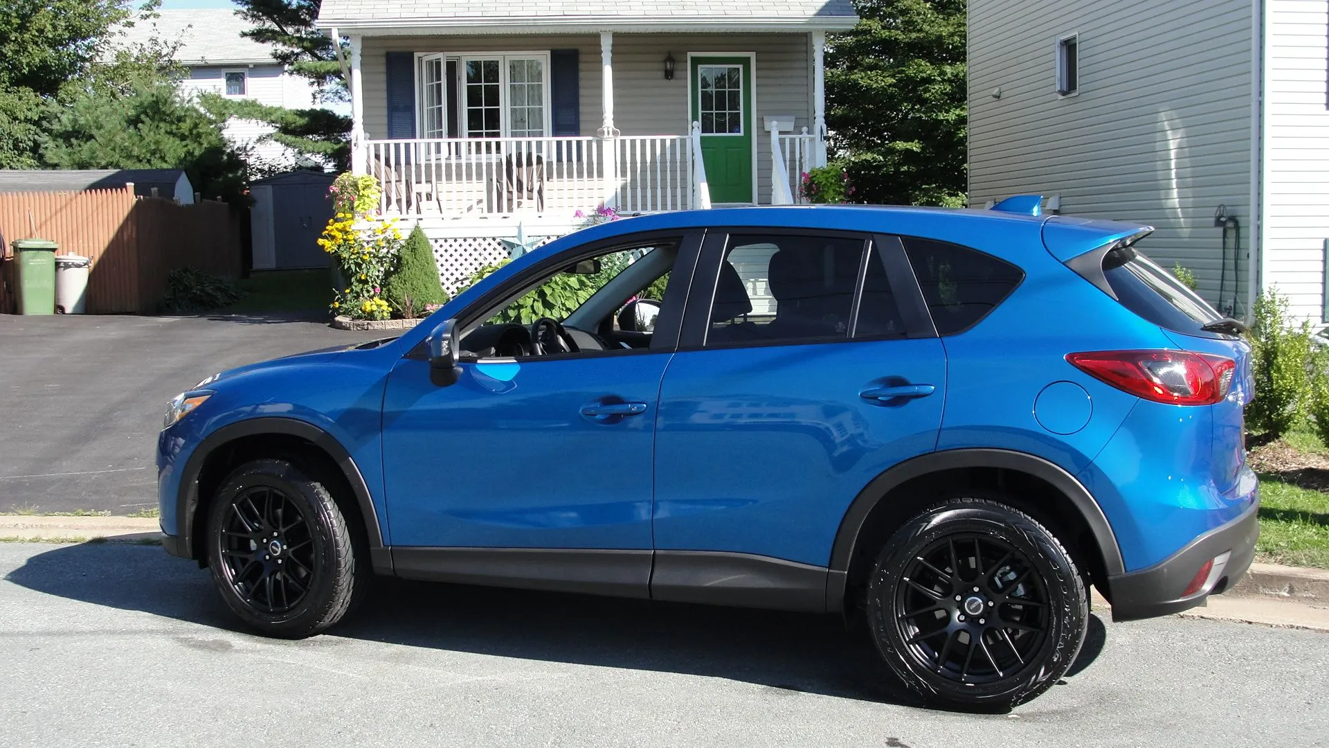

Considering the same. I posted this a few days ago, body lowered a touch. I need to chew on this for a while. This would probably cost (Chicago) $450 total. Going 20s for summer with new tires, $2k. If I do either I want to be sure I'm going to like it for the long haul. Has anyone done winter tires on the stock 19s?

Love that bright blue! I wish they had some in the Chicago area, but the red is pretty nice too. Nice wheels as well.

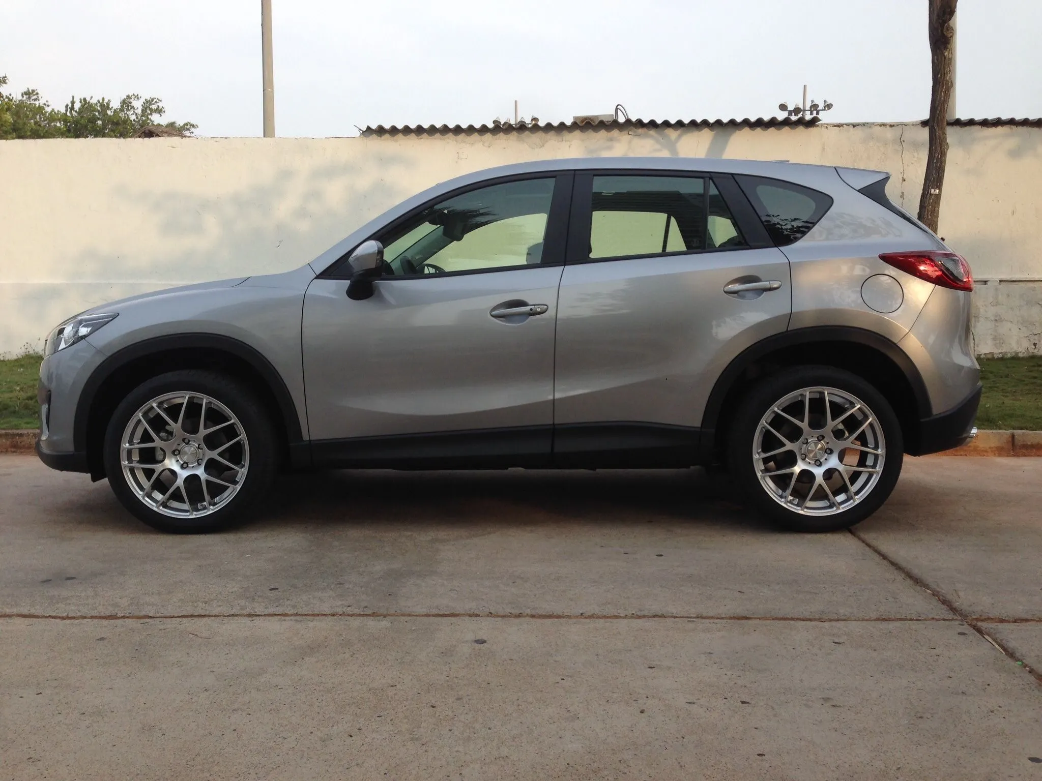

The wheels I ordered (TSW Sochi 20 x 8,5 ET 40 Rotary Forged with 245/45/20) are lesser weight as the stock 19 " with 225/55/19 on the CX-5 !!! (photos within 25 days from now on)

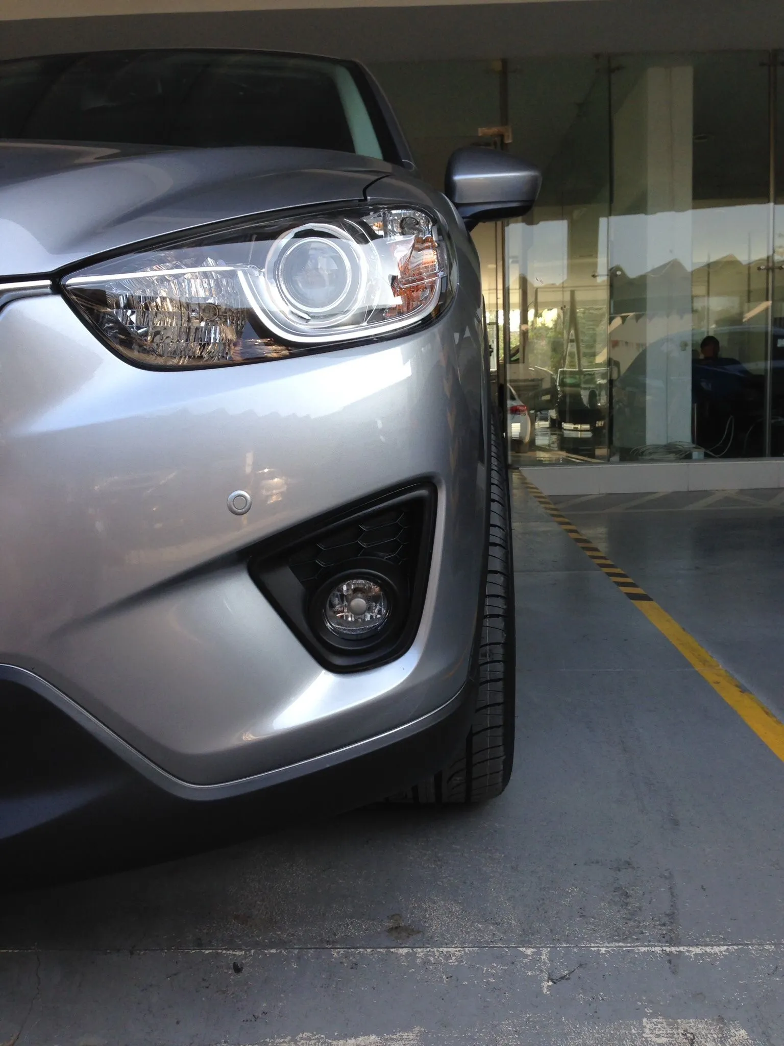

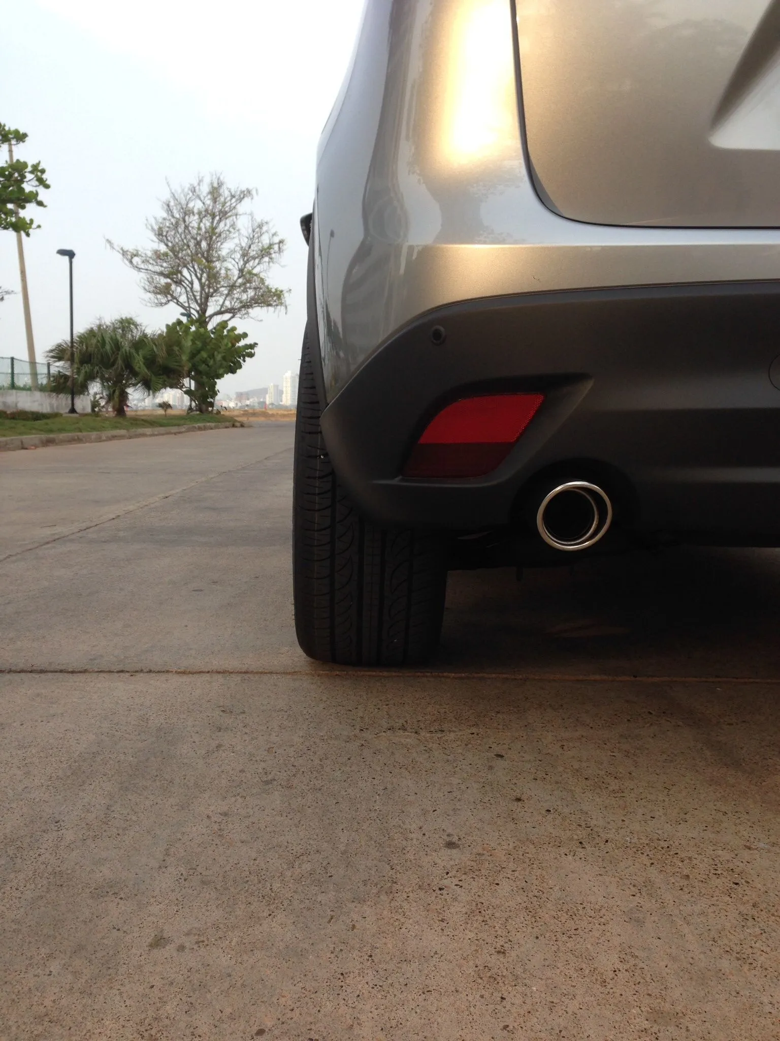

Hello, finally got my CX5! So far its been great
Ill post more detailed pictures this week
wheels are 20x9x30 offset, 265/40r20

Those wheels match the CX-5 better than almost every wheel I've seen on this forum. Props for good styling and proper sizing.
